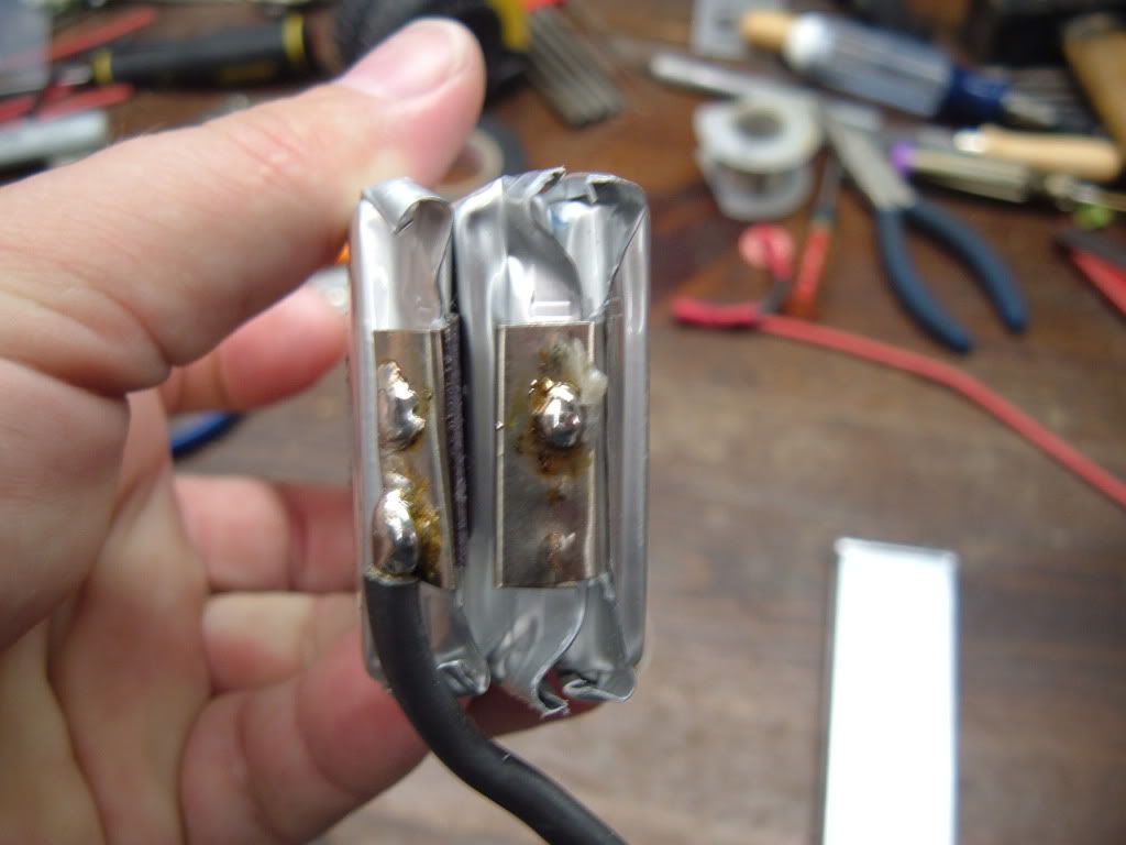

lincpimp 03.13.2009 11:17 AM

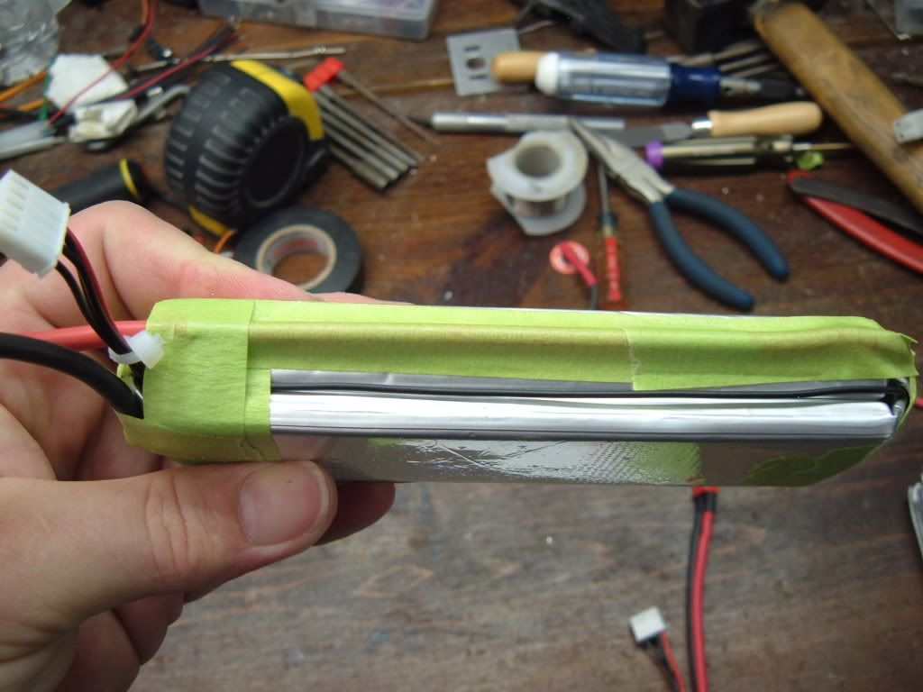

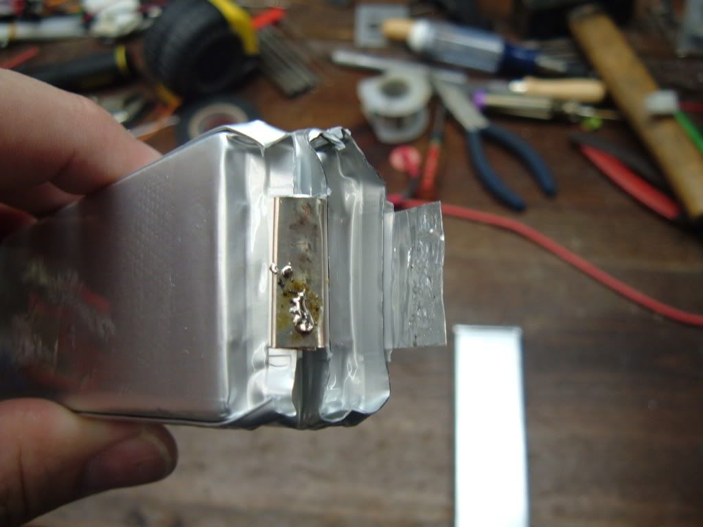

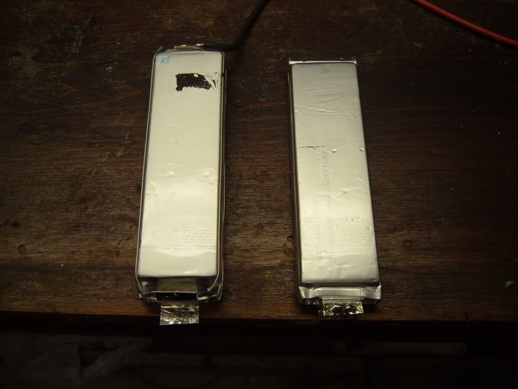

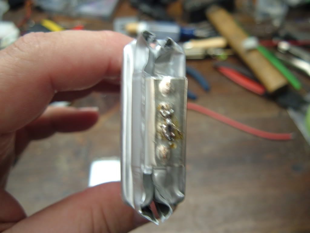

Ok, more pics on skellyo's packs.
Here are a few shots of the 5s pack with the tp balancer wiring removed and split into a 2s and 3s pack.
http://i206.photobucket.com/albums/b...p/DSCF3123.jpg
http://i206.photobucket.com/albums/b...p/DSCF3124.jpg
http://i206.photobucket.com/albums/b...p/DSCF3125.jpg
http://i206.photobucket.com/albums/b...p/DSCF3126.jpg
http://i206.photobucket.com/albums/b...p/DSCF3127.jpg

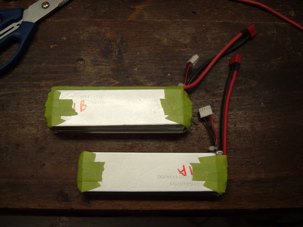

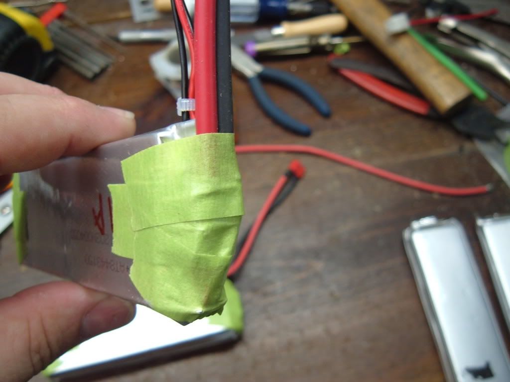

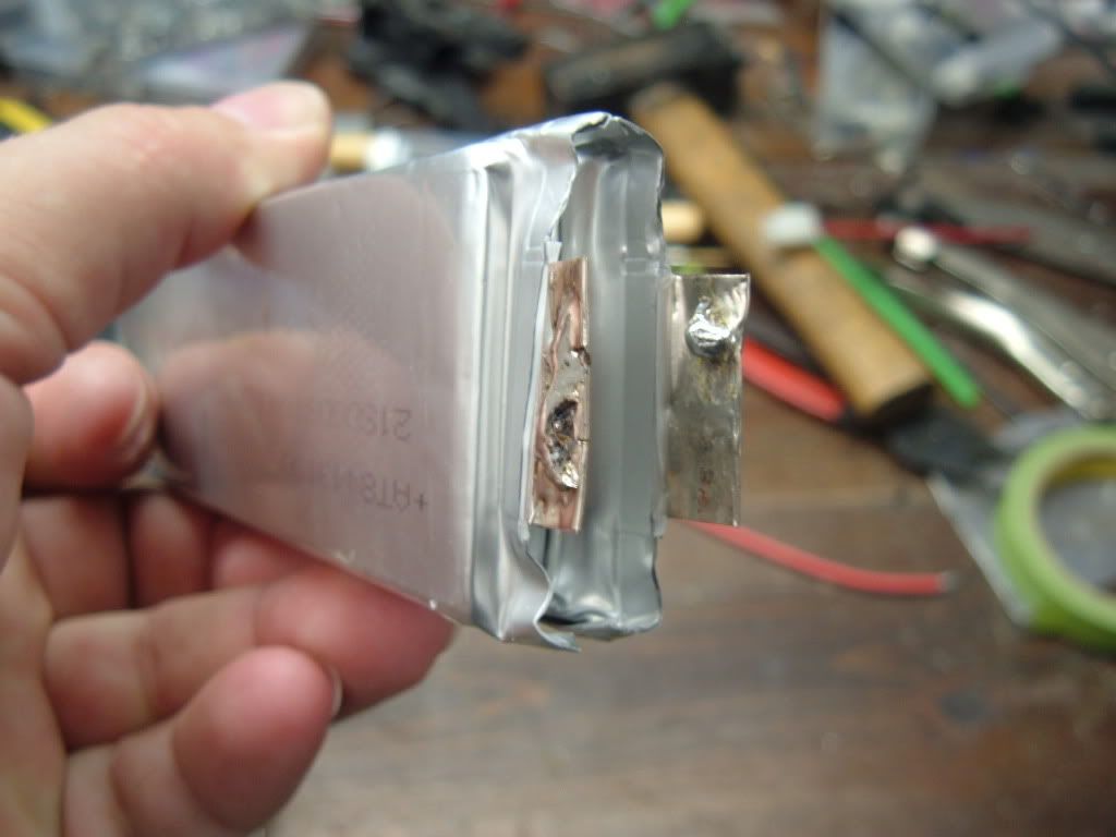

lincpimp 03.13.2009 11:23 AM
And a few more pics of the 2s and 3s pack after I put the hyperion taps and taped them up.
Note the green masking tape. I use this as it does not leave any glue residue, like electrical tape does. It is also quite stretchy, and does not shrink or grow. Plus I have dozens of rolls of it at work. I use it to cover the individual cell tabs and then layer it up on the ends for added protection. I sometimes wrap the packs in thin clear packing tape, but these cells have a double sided tape that holds the cells together so they are attached to each other well. Cell shifting is a big problem, so it is good to make sure the cells are held together well.
http://i206.photobucket.com/albums/b...p/DSCF3128.jpg
http://i206.photobucket.com/albums/b...p/DSCF3129.jpg
http://i206.photobucket.com/albums/b...p/DSCF3130.jpg
lincpimp 03.13.2009 11:29 AM
Another little bit of info. Note that I have a small ziptie on the balancer wires. I do this to keep them together and provide a bit more strength. On the enerland cells that have tabs on each end some of the tap wires run along the side of the pack. I tape them down to keep them in place. The tap wires that attach on the top of the pack are looped under the tap to give them some strain relief. Some people are a bit rough with balance taps and this helps the wires survive and not tear off where they are soldered. Seems like zippy and venom packs are bad about this, as the align style taps usually have the thinnest wires in the balance harness.
Just a little info I though I would share.
