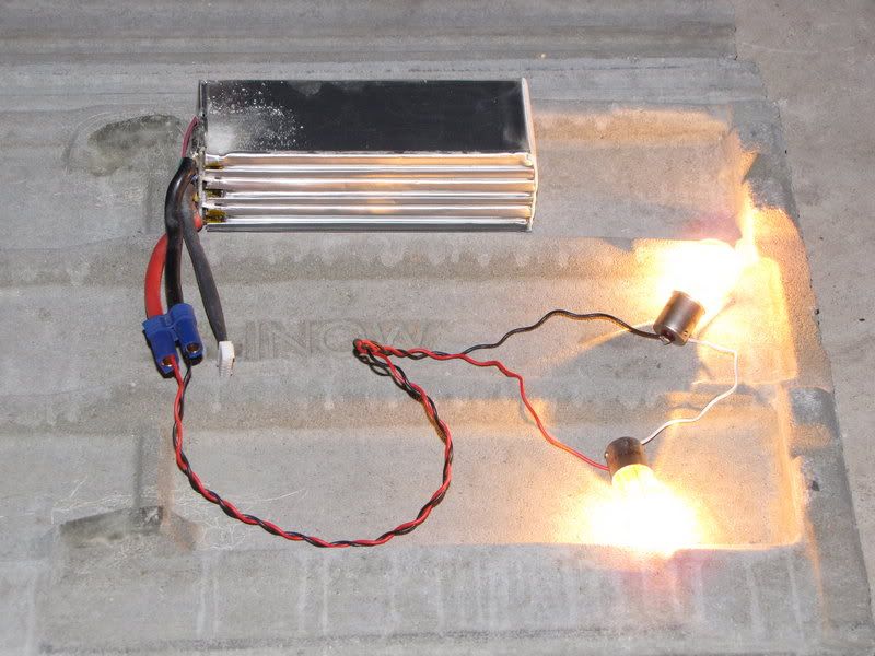

One of the batteries I was using for this truck went bad (charger only picks up 5 cells and I can't see any connection probs with the balancing lead). So I had a look around to see how to dispose of it. It seems they are safe for landfill but should be discharged first to prevent accidents. Quite a bit of older info says to submerge in a bucket of water (correction salt water) for a couple of days to discharge. Other info I have found though says this isn't fool proof and sometimes not all the cells discharge due to electrolysis erosion. Digging a bit further, instead of using the water it's suggested to use a resistive element to fully discharge the battery. Below is my rig to do that, just a couple of 12 volt car light bulbs.
http://i1010.photobucket.com/albums/...humbnail-1.jpg
Apparently the battery can puff even if slowly discharged and the gases are flammable so the cells should be punctured after the discharge. Nail taped to a broom handle? Hopefully mine doesn't puff.
