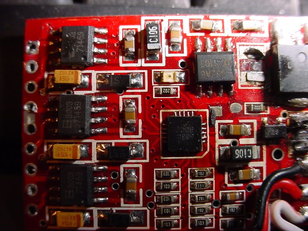

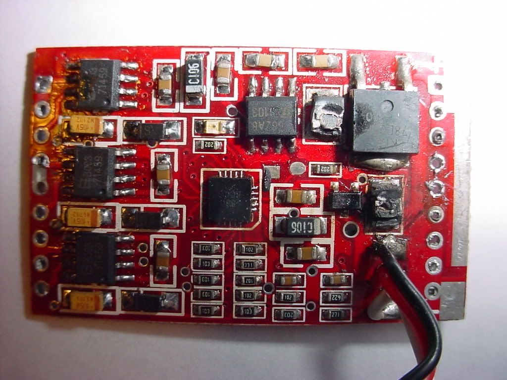

OK, I got the Brain Board lifted.
Here's a picture.
OK class! Quiet down! Can anyone guess what's wrong with this picture?
That's any easy one huh? OK, is there an advanced student in here that can tell me why this happened? :lol:

MetalMan 02.24.2008 09:20 PM
It's kinda hard to tell what exactly those are that blew, but to me they look like diodes (on the right). On the top left something else looks blown, but I don't know what it is.
sikeston34m 02.24.2008 09:22 PM
Those two components are connected in series to the center (red) receiver wire.
lincpimp 02.24.2008 09:52 PM
Internal BEC?
Do I win anything?
sikeston34m 02.24.2008 10:07 PM
Originally Posted by lincpimp (Post 151240)
Internal BEC?
Do I win anything?
Ding! Ding!
Now let me tell you what you didn't win! LOL :rofl:
The big square thingie in the top right with the legs. Well that is a linear regulator. Those things you hear about that reduce the pack voltage to 5v? Well that's the heart of it.
The two burnt thingies, I believe to be Diodes. I'm not 100% sure on that though. (Griffin, can you help me out here?)
One thing that was very puzzling about this is the fact that we have continuity between the red receiver (power) wire and the Black Negative.
I spotted a melted spot in the receiver wire. Very flat and I was thinking this was the source of the whole problem. I removed the wire. Problem is still there.
I removed the two burnt thingies and the continuity is gone. Even though continuity is now gone, I still don't have infinity.
I'm still getting .288 kohms between the Linear regulator and the red wire.
I believe the regulator chip is fried too, even though it doesn't show as much damage externally.
Can I remove the regulator altogether and run this ESC with the Opto Mod?

lutach 02.24.2008 11:11 PM
I'm not 100% sure, but I think you can. Here is a picure of an OPTO Hacker controller (http://www.rc-monster.com/forum/atta...2&d=1202243485) and you can see 3 silver spot where usually those components would be. Probably tomorrow I will send Artur my Hacker and the other ESC to see if he can swap MCUs. Sikeston, can you post the number on the driver and what that symbol is? Also, what is the part number on the MCU? It looks very much like a Silicon Labs.
sikeston34m 02.24.2008 11:51 PM
This is some really tiny stuff. This Camera can see better than I can. LOL
I hope this helps.
http://i160.photobucket.com/albums/t...m/DSC06839.jpg
