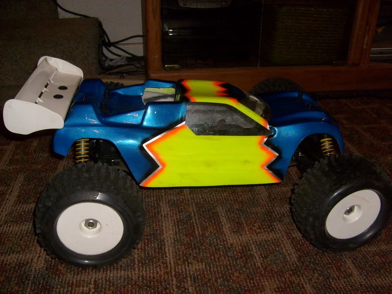

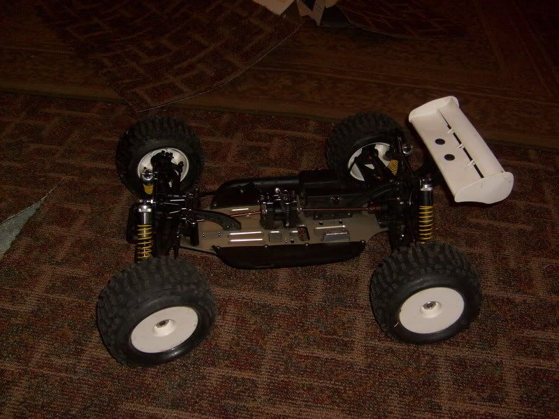

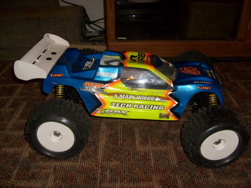

here are some pics!
awsome packaging.
http://i86.photobucket.com/albums/k9...2/S6301146.jpg
http://i86.photobucket.com/albums/k9...2/S6301147.jpg
before
http://i86.photobucket.com/albums/k9...2/S6301150.jpg
after
http://i86.photobucket.com/albums/k9...2/S6301152.jpg
ill definetly be getting another body but for now this is all i have!

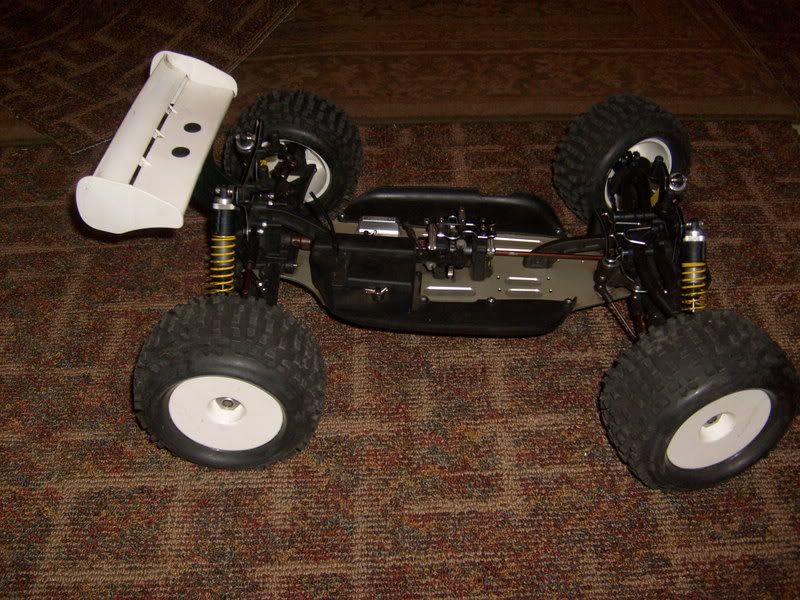

t-maxxracer32 11.21.2007 09:23 PM
http://i86.photobucket.com/albums/k9...2/S6301160.jpg
http://i86.photobucket.com/albums/k9...2/S6301159.jpg
http://i86.photobucket.com/albums/k9...2/S6301158.jpg
http://i86.photobucket.com/albums/k9...2/S6301157.jpg
http://i86.photobucket.com/albums/k9...2/S6301154.jpg
as you can see i still have the other half of the motor mount connected... the screw is stripped... its a hex head so what do i do? drill it out?

Sometimes you can get screws out by using a cutting wheel on a dremel and putting a slot for a blade screw driver in the head of the screw. Could be hard if it's a counter sunk screw and you don't want slices in the bottom of your chassis. If not you may need to drill. Do you care if the motor mount get damaged? If you don't drill perfectly straight it will be easy to damage the internal threads in the mount.

also i dont care about the mount at all so i will just drill right through it tomorow.
