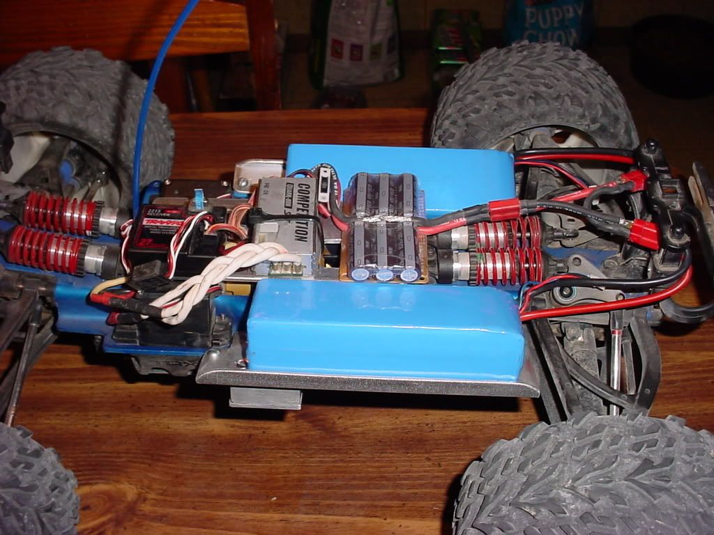

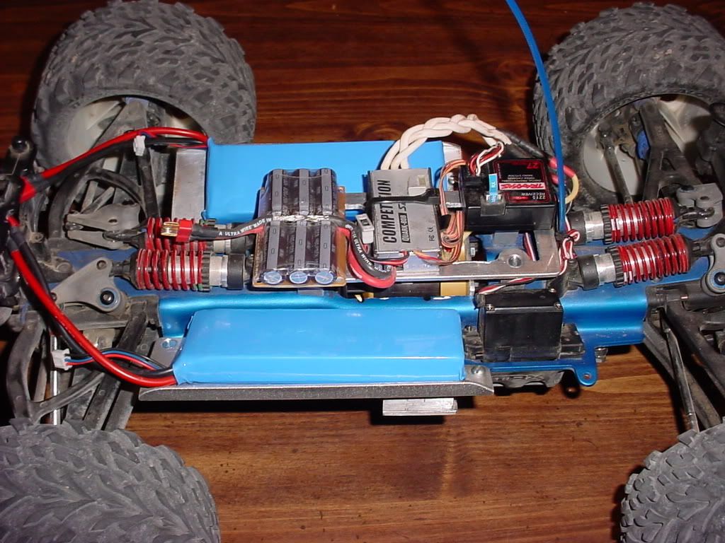

Got a little bored waiting on parts to get here. So I decided to enlist the Revo in a weight loss plan! :lol:
She went from 9lbs 8 ounces, without batteries, to 9lbs 1 ounce. When I change motors, another 4 ounces will drop to make the weight 8lbs 13 ounces. I'm thinking about maybe trying the Badlands tires/wheels, so that might shed a little more weight.
I decided to get rid of those gawdy "sideboards". I shaved them on down. This allows me to lay my Lipo's down for an even lower center of gravity.
http://i160.photobucket.com/albums/t...m/DSC06662.jpg
Ok, maybe 4 Series 10,000mah Lipo's are a bit bulky. How about 4 Series 5000mah Lipo?
http://i160.photobucket.com/albums/t...m/DSC06663.jpg
OR, if I can settle on a HV ESC that I like, How about 8S1P A123?
http://i160.photobucket.com/albums/t...m/DSC06666.jpg

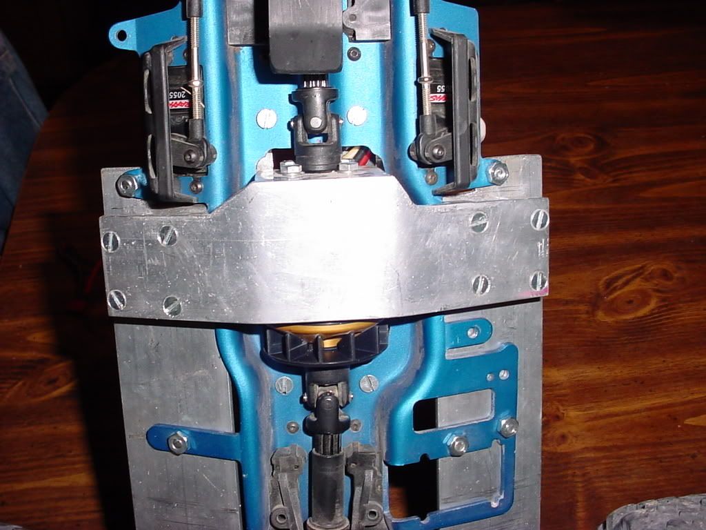

I also trimmed and slimmed up the motor mount some.
http://i160.photobucket.com/albums/t...m/DSC06667.jpg

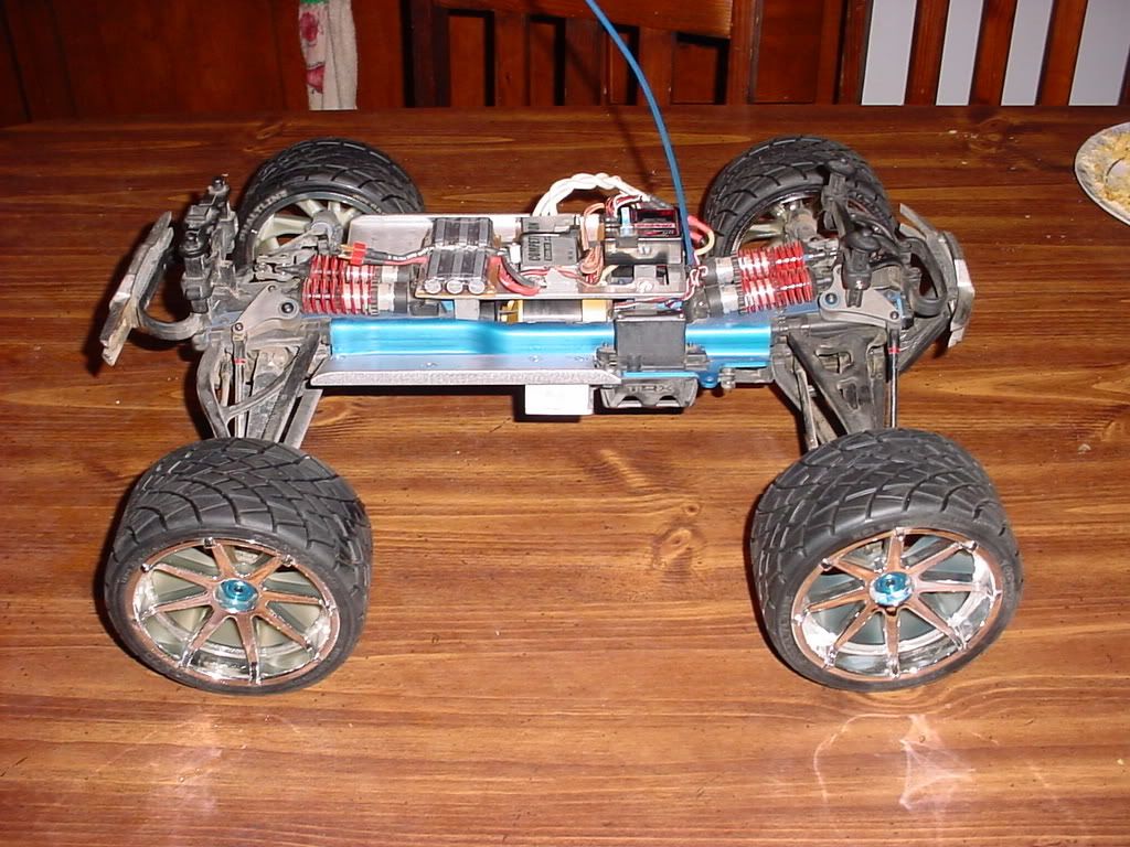

Do these Wheels and Tires look funky? Good for Asphalt Speed runs I think.
http://i160.photobucket.com/albums/t...m/DSC06670.jpg
squeeforever 11.26.2007 12:35 AM
I LOVE the Phaltlines!
zeropointbug 11.26.2007 03:43 AM
Sike, this is coming together really nicely man. It's looks fine with the 10Ah lipo's on there... that would make for some nice runtime at that, 40 mins at least at 40 mph.

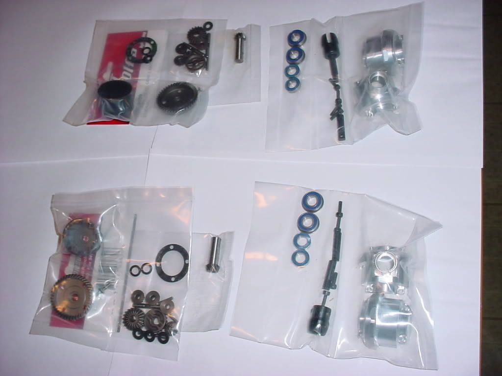

Parts ARE IN!!!!
Wooo Hooo! Look what I got!
http://i160.photobucket.com/albums/t...m/DSC06675.jpg
I got the new motor also.
I've got to hand it to Mike on this one! Fast Shipping and great service. These new diffs look beefy! I guess I better go get to work on this! :yes:
