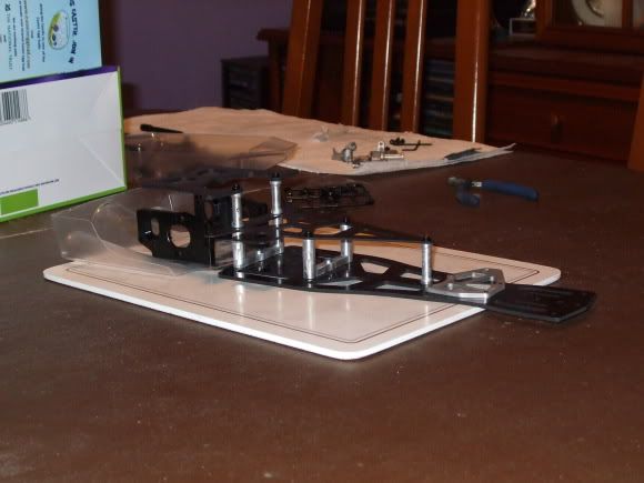

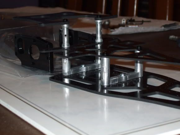

Here are some images of the chassis as it sits now:
http://img.photobucket.com/albums/v6...r/HPIM1685.jpg
http://img.photobucket.com/albums/v6...r/HPIM1686.jpg
http://img.photobucket.com/albums/v6...r/HPIM1687.jpg
http://img.photobucket.com/albums/v6...r/HPIM1688.jpg

H'okay, got a very minor bit of progress done while I wait for funds to amass. Nothing exciting, but I thought I'd post anyway lol. I went down Tesco's and bought a bottle of Domestos Pipe Unblocker, and de-ano'd all the aluminium 3racing bits. I then took a hacksaw, file and wet & dry paper to the two main aluminium top deck support parts, in order to get rid of the stock-style battery clip mounts. These added unnecessary weight, and unnecessary weight gets the chop in this car! B) Even if it's the slightest thing. I also discovered that the rear body mount plate does perfectly well with only the two inner aluminium standoffs, losing no real rigidity. I might cut some excess material off of the plate itself at some point, but I'll leave that for now.
http://img.photobucket.com/albums/v6...r/DSCF0102.jpg
http://img.photobucket.com/albums/v6...r/DSCF0103.jpg
Sorry about the naff images btw...I just rushed them lol. Thanks for the interest in this by the way...I really appreciate it!
