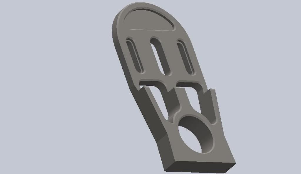

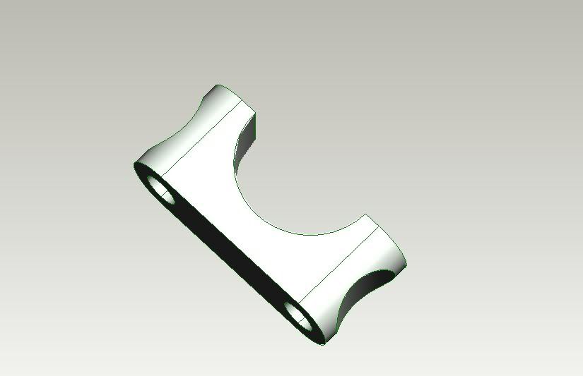

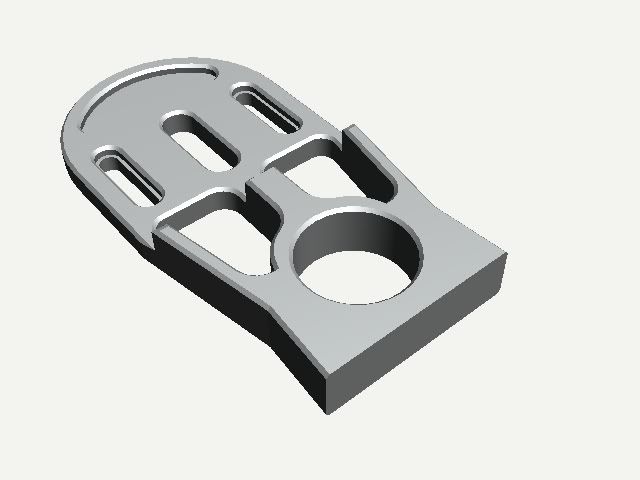

brushlessboy16 08.20.2008 06:28 PM
http://i152.photobucket.com/albums/s...arhead/4th.jpg
http://i152.photobucket.com/albums/s...stmountpic.jpg
http://i152.photobucket.com/albums/s...arhead/2nd.jpg
brushlessboy16 08.20.2008 06:30 PM
mike you better be watching in case you need a designer, "will work for lipos" :D
let me know what you think guys
JThiessen 08.20.2008 07:05 PM
Keep in mind cutter radii. If you look at your part, the "eye drops" I'll call them (the two lightening holes on either side of the larger hole at the bottom of the part) will be very tough to machine. Otherwise it looks buildable
brushlessboy16 08.20.2008 07:18 PM
we have a mini cnc router that used a 2mm bit- all the radii are 1.5 or more, should be fine

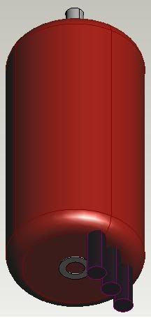

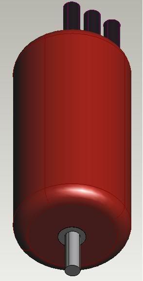

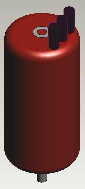

Decided to take a shot at the CAD program myself. Got a few tips from ben and from a few vids. Here is a rough draft of my brushless motor I made...
http://i301.photobucket.com/albums/n...RCU/motor1.jpg
http://i301.photobucket.com/albums/n...RCU/motor2.jpg
http://i301.photobucket.com/albums/n...RCU/motor3.jpg
brushlessboy16 08.21.2008 06:20 PM
dont look half bad ryan :D
Takedown 08.21.2008 07:01 PM
Thanks ben. Its become an addiction now to me. :lol:

update, revised front CD mount-now with more Beef
http://i152.photobucket.com/albums/s...dammitwork.jpg
Arct1k 08.21.2008 10:44 PM
Looking good...
Drop the brake holes and it should be ok... Still think you need more screw depth for the diff plate and bottom screws...
