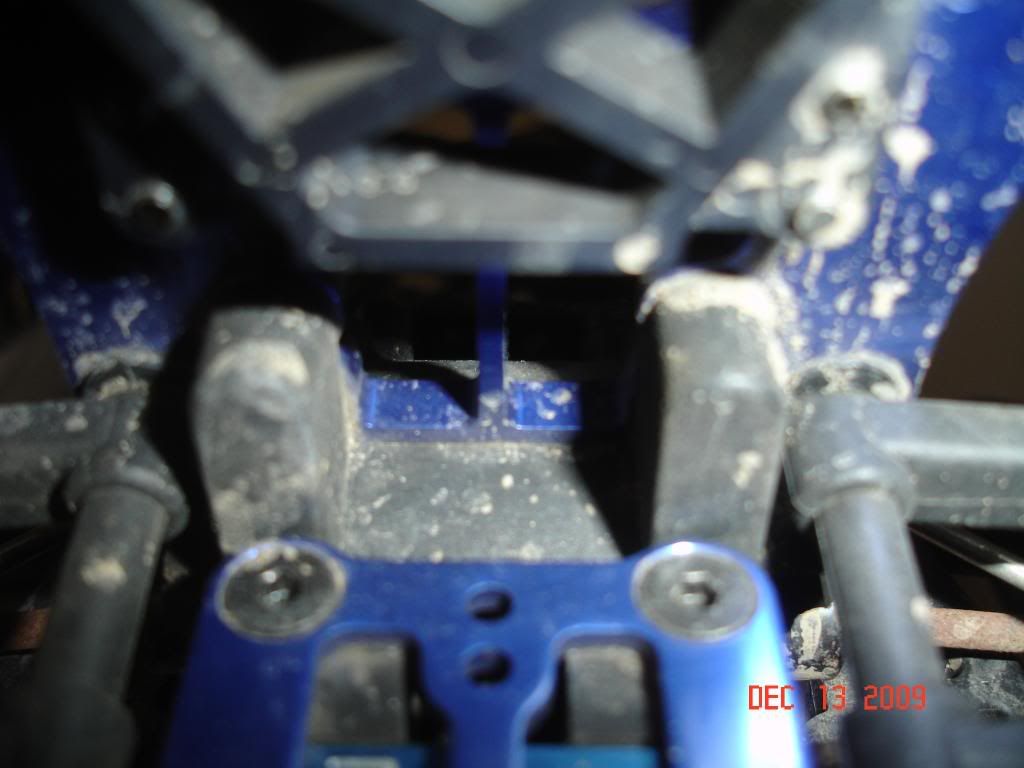

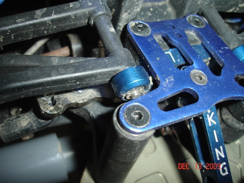

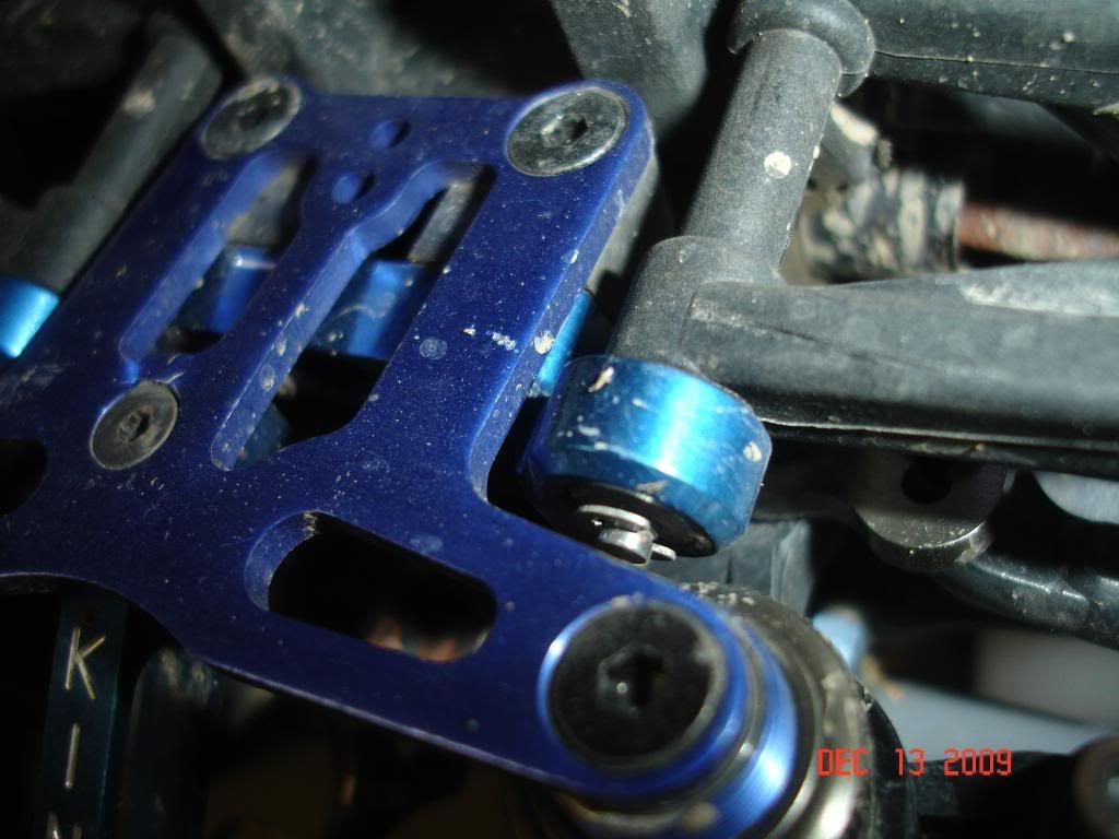

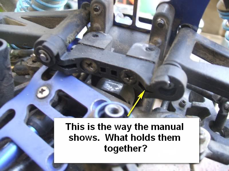

I have some universial shafts coming in the mail and one last part to get installed correctly and I almost have a STRR. I need some help though with the suspension pivot block that hold the top front arms in place. I installed it the way the exploded view shows to with the oblonged O part on hte inside of the pivot block but it doesn't hold in there. Just comes out. I tried with the O on the outside and it doesn't seem right either. What holds them in? Do I have something backwards?
http://i212.photobucket.com/albums/c...frontsusp1.jpg
http://i212.photobucket.com/albums/c...FrontSusp2.jpg
http://i212.photobucket.com/albums/c...frontsusp3.jpg
I've read before that these were confusing and now I agree. Do I need additional parts or more common sense?

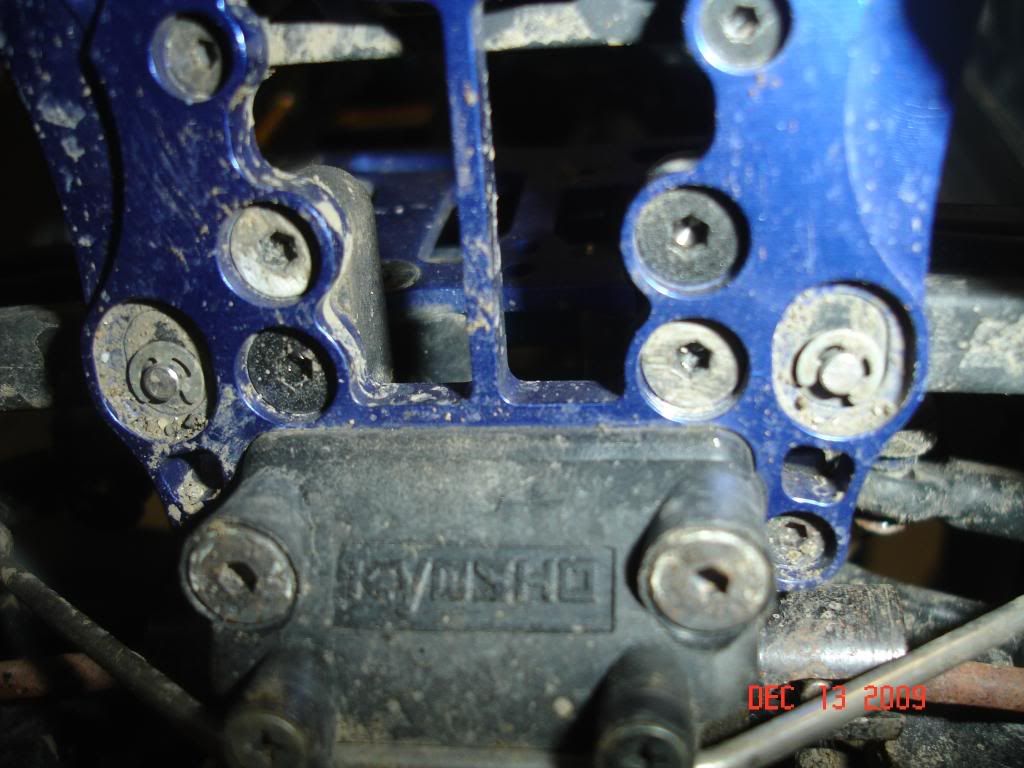

George16 12.12.2009 07:41 PM

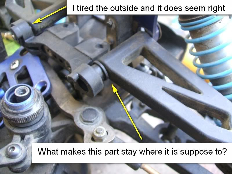

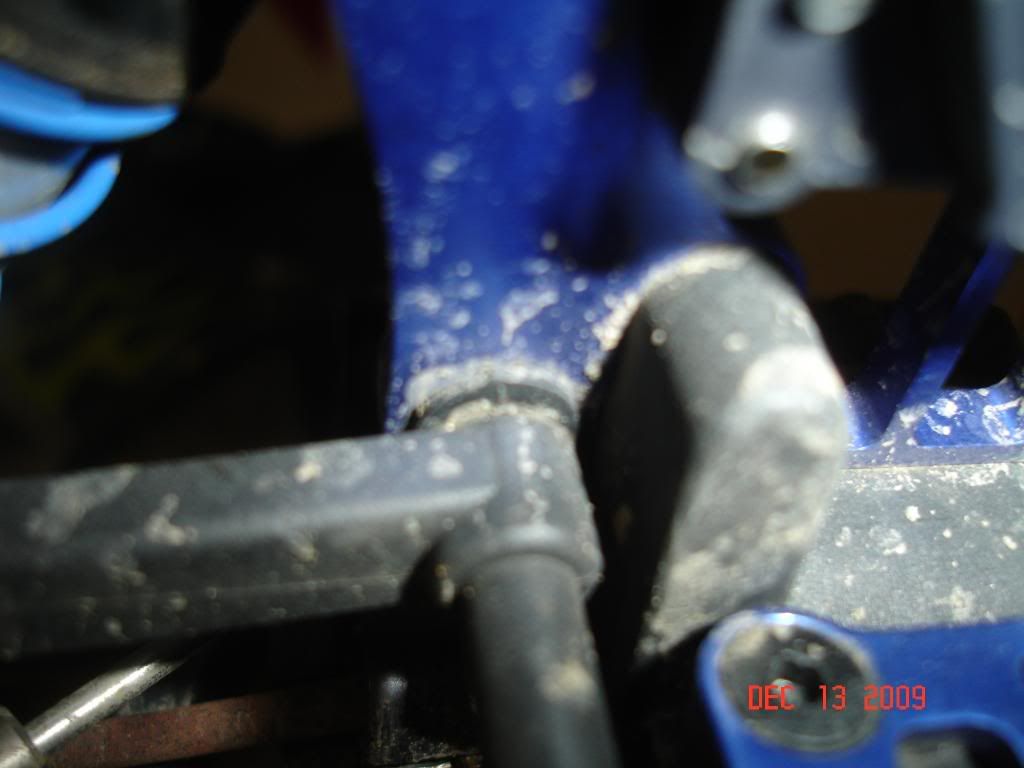

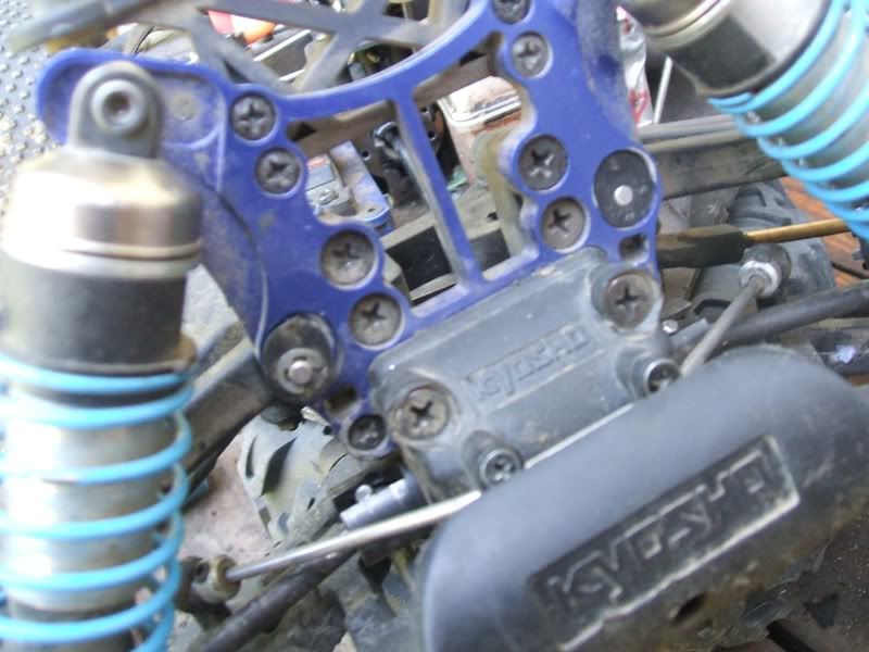

Gee, the oblonged "O" (#65 on diagram 16 on page 15 of the manual) has to be installed between the forward part of the upper A arm and the shock tower(it will be sandwiched in there). Then you insert part #275 (3 x 47mm shaft) and keep them in place by a pair of 2.5mm E-clip.
On your third picture, that Oblong plastic was installed incorrectly.
I can see where you got confused. You were looking at diagram 15 on page 15 .
Looking from the front:
http://i256.photobucket.com/albums/h...R/DSC06697.jpg
You can see the difference from this pic compared to yours:
http://i256.photobucket.com/albums/h...R/DSC06698.jpg
http://i256.photobucket.com/albums/h...R/DSC06699.jpg
You can see the plastic Oblong part between the shock tower and forward part of the upper A arm here:
http://i256.photobucket.com/albums/h...R/DSC06700.jpg
http://i256.photobucket.com/albums/h...R/DSC06701.jpg
You need more common sense :lol::lol::lol::lol:. Hope these helps.
