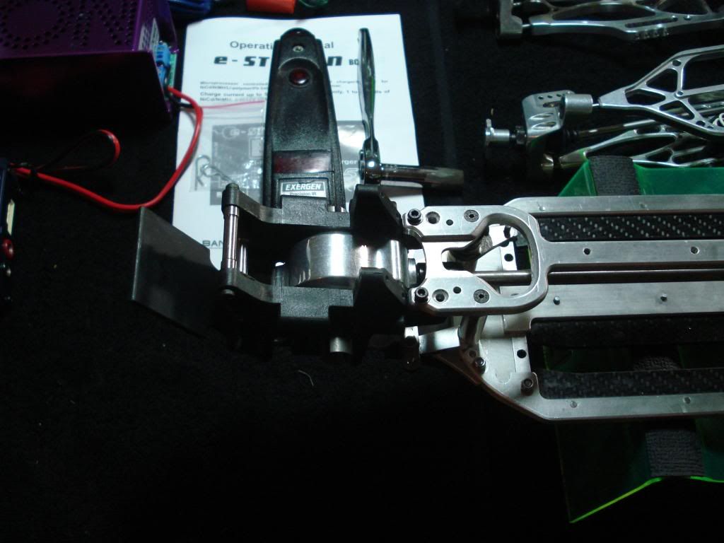

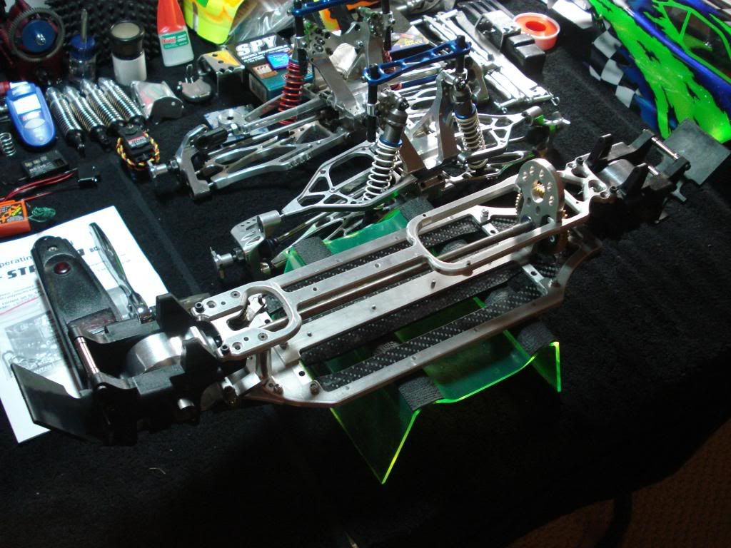

need a part fabricated for custom EMAXXIMUM creation
THIS IS THE PIECE:http://i302.photobucket.com/albums/n...s/DSC01349.jpg
IT GOES HERE:http://i302.photobucket.com/albums/n...s/DSC01351.jpg
THIS IS THE FULL CHASSIS PIC:http://i302.photobucket.com/albums/n...s/DSC01342.jpg
PLEASE HELP ME GET THIS RIG RUNNING:
http://i302.photobucket.com/albums/n...s/DSC01406.jpg
http://i302.photobucket.com/albums/n...s/DSC01398.jpg
http://i302.photobucket.com/albums/n...s/DSC01392.jpg
i can mail the broken piece out for duplication...it holds the steering servo in place!!

MetalMan 10.05.2008 02:58 PM
Is that part made from polycarbonate/Lexan? If so, would you want it to be made from polycarbonate again? Or maybe aluminum for greater strength?
plettenbergs 10.05.2008 03:03 PM
yes i want aluminum or carbon fiber!...great question....can you make it?i would like for it to be like a square box over all for corners of the top of the servo
BL_RV0 10.05.2008 03:16 PM
MetalMan is exactly that. MetalMAN! Of course he can make it! :lol:
MetalMan 10.05.2008 06:07 PM
I am not quite sure I understand what you mean. Are you wanting something that will completely encase the servo, and then mount to the upper deck? Just FYI I don't have a mill or any real milling capabilities, and I also much prefer to not work with carbon fiber (it's not friendly to my tools or me).
plettenbergs 10.05.2008 07:32 PM
i dont care if it is carbon...aluminum is fine!...i just wanted something to fit over just the top of the servo to hold in place well...an exact copy(from metal) of what i have would work fine...do you have a better idea??...i am open to suggestions...i will make at least one run of 10 prototypes and you can have a shot at one if you lke!!

as for the servo hold-down thingy, are you just wanting to replicate one in alum?
shouldn't be hard to do, get a piece of plate alum, cut it to the right shape (waterjet or laser) then just get the threads cut into it.

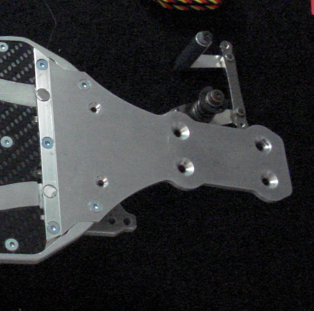

E-Revonut 10.06.2008 04:03 PM
1 Attachment(s)
Here's what I made for you, let me know if you want it.
plettenbergs 10.06.2008 04:09 PM
that should work!thanks!

plettenbergs 10.06.2008 11:12 PM
chassis with Traxxas bulks and UE diffs!...http://i302.photobucket.com/albums/n...s/DSC01477.jpg
http://i302.photobucket.com/albums/n...s/DSC01481.jpg
http://i302.photobucket.com/albums/n...s/DSC01482.jpg

plettenbergs 11.11.2008 08:05 AM
hey Lito check this out!
http://i302.photobucket.com/albums/n...s/DSC01339.jpg
http://i302.photobucket.com/albums/n...DSC01340-1.jpg

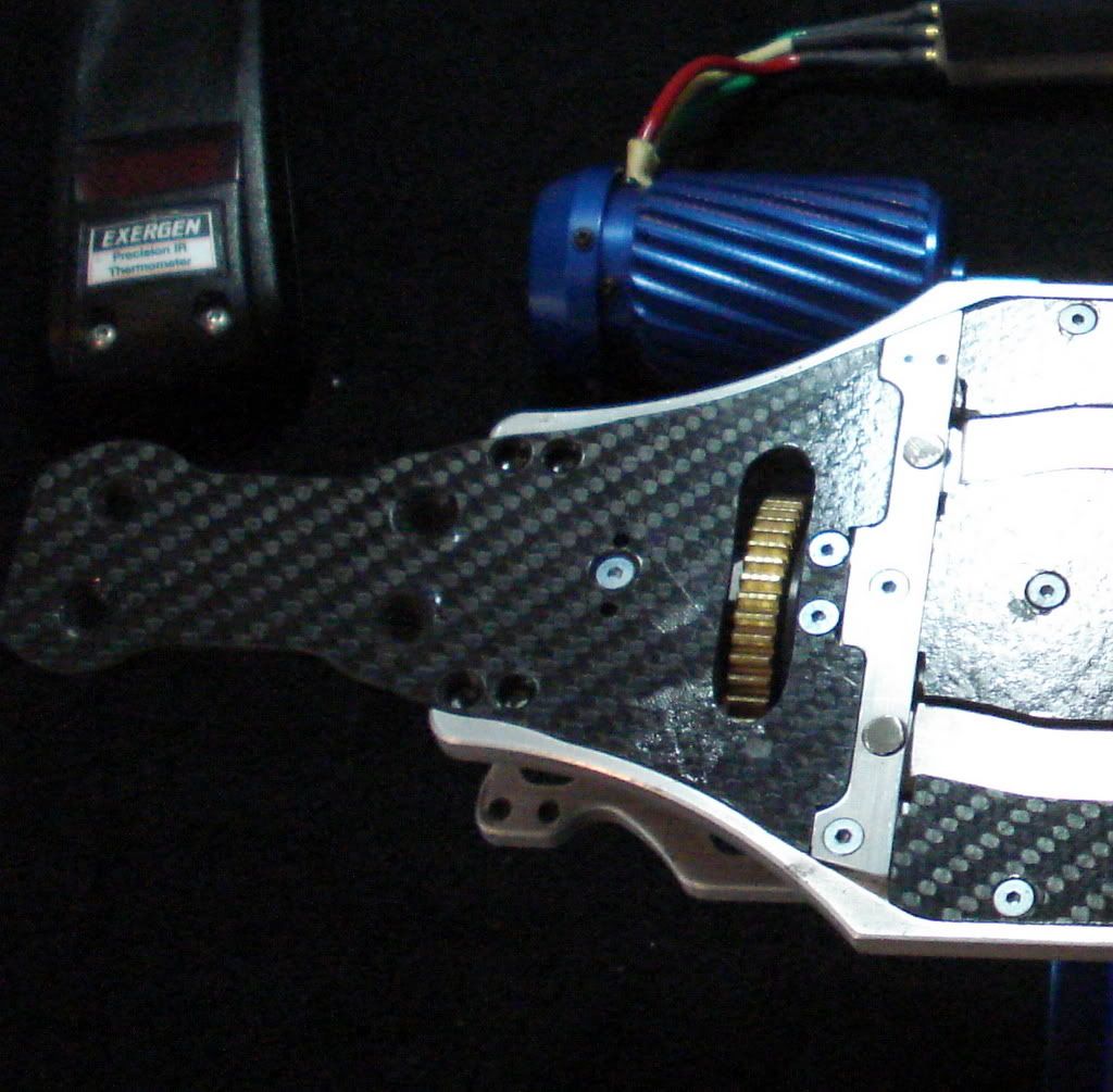

the front and rear clip are removable so for "a few dollars more" i can send you VBS and standard(stock emaxx bulkhead application) front corbon fiber or aluminum clips!
George16 11.11.2008 09:50 AM
That is awesome. I will go with that route then so if I feel installing my VBS, it will just be a cinch.
Is it 7075T6 or 6061T6?
plettenbergs 11.11.2008 01:25 PM
6061T6...3mm carbon fiber

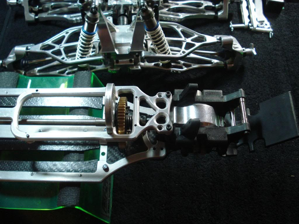

you mentioned going with a robinson racing slipper- the t-maxx slipper is 32 pitch, while the monster gt rr slipper is the more favorable mod 1 pitch. Mounting on both is identical. The only drawback is that the mgt slipper only comes with a 54 tooth spur gear which is 56mm in diameter. The mgt is the way to go, I just don't know if space will allow for it.
George16 11.11.2008 06:26 PM
The MGT comes in 46, 49, and 52T. You can drill 3 new holes in order to mount the MGT spur to the tmaxx slipper or use a strobe slipper with a 51T Ofna spur.
plettenbergs 11.11.2008 08:44 PM
i have both(mgt and tmaxx slipper) in my bag of goodies...the MGT might win due to smaller diamiter!...if it is too large it will protrude through the bottom of the chassis requiring a custom spur gear skid!...i am taking several over tomorrow for fitment!(is that a word?)...FYI:the shaft is 8mm
_paralyzed_ 11.11.2008 09:27 PM
the mgt comes in more sizes than that when you include kimbrough and delrin spurs, however, we are talking specifically about the robinson racing slipper and spur, which only comes in 54 tooth

I gave the CNC guy $1500 cash last week to to make his pocket happy!...will be using the 64-70 tooth RR slipper gear and pads but will have to make custom pressure plates to fit the 8mm DirectDrive shaft!....THEY ARE COMING!!!!
Revised prototype should be here very soon,after i ok it he will run the other 15 chassis!....the machines will be set-up already and he will just press RUN on the giant HAAS CNC machine!!!....that baby will spit them out very quickly!!!

i am considering adding some small slits in the lower carbon fiber deck so i can velcro in a batt tray...no big deal,i mounted 2 5s Zippys with no problems to my prototype!...velcro on the bottom of the batts and a strap to the upper deck!http://i302.photobucket.com/albums/n...s/DSC01398.jpg
