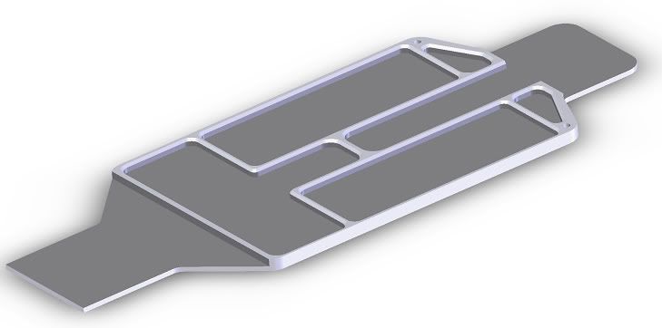

I have started a new project. It will be a brushless TC3. It will be running a Feigo 540C 9L motor. For batteries I will be running 2 poly-quest 2s 3100mah lipolys. I have not decided on the controller yet. This is the chassis design so far. It is currently being machined as I type this by Andrew at Cold Fusion Racing.

CrazyPhantom 11.20.2005 08:37 PM
got pictures of the chassis cut. Thanks to Andrew over at Cold Fusion Racing.

Yeah, I will for sure. Im currently working on a motor mount that will get the CG lower then my first design.
Serum 11.21.2005 02:42 PM
Looks great so far! have you got more plans/drawings of that truck to share?

yes, I will get some more drawings up tonight

Yeah, If you think the chassis looks good in a picture, you should see it in real life. This is only the mock up chassis to beleive it or not. I need to change a few things here and there, and then have Andrew over at Cold Fusion Racing cut me another one. I decided that I am going to try to run dual lipoly packs. Now I have to find a pack that will fit with out me having to rearrange the steering setup on the car. I think Im going to get the poly-quest 3100N 7.4V batteries, becasue they are the closet thing I can find to fitting and still near the mAH's I'm looking for. The motor will be mounted above the spur gear, trying to keep it as low as possible still. Well, I gtg to bed, so more updates will be up tomarro if I have any (Final chassis design will most likely be done tomarrow)

CrazyPhantom 11.29.2005 07:07 PM
Final chassis design, waiting on the final check on measurements from the place Im getting my poly-quest lipolys from, and then the chassis will be cut.

Crazy that chassis looks great. Are you going to have andrew make a top plate, to help with chassis flex ?.
CrazyPhantom 11.29.2005 09:08 PM
I do not beleive that there will be alot of chassis flex, but I do plan on getting a carbon fiber topdeck machined just for looks if anything.

nice look, u got liek batt holders or stuff like tha tmade up yet?
CrazyPhantom 11.29.2005 09:17 PM
The batteries will sit in those pockets on both sides of the chassis, no need for battery cups.

The CF top plate will look killer with the aluminum. There is more flex than people think in those little cars, especialy when you come to a sudden stop :L: .
