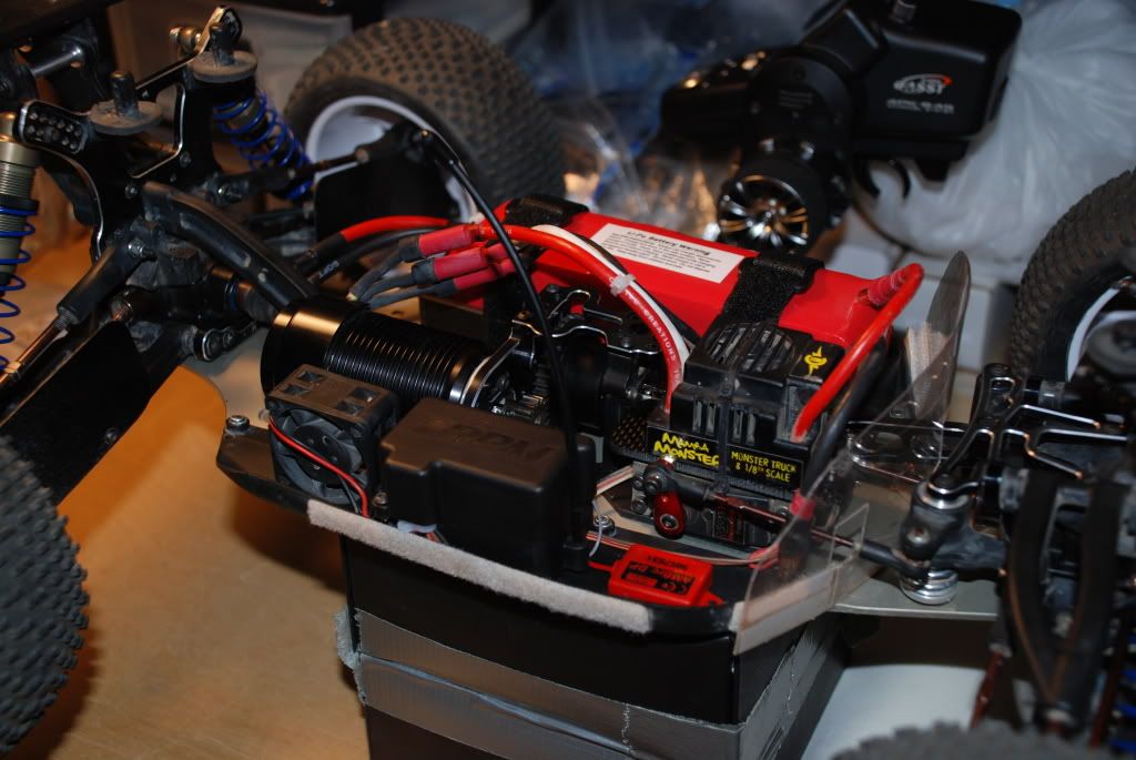

tha5150 01.04.2009 05:26 PM
ok here are 2 pics i just took. dont mind the dirtyness and zip ties. i have not touched t since i drove 30 min to the track today and couldnt move 1ft. i think this IS the RCM mount. you tell me..

E-Revonut 01.04.2009 05:30 PM
Either your using the wrong pitch pinion for the spur or your not setting the mesh right
BrianG 01.04.2009 05:30 PM
Hmm, the problem probably isn't the mount then. How are the CD bearings? Is there any side-to-side play in the CD?

brushlessboy16 01.04.2009 06:09 PM
looks like the pinion doesnt mesh with the spur fully.. looks liek u should have a bigger pinion

You need a new mod1 pinion. Yours has most likely been used with a steel spur at one time. I can see a couple of the teeth on the top that have been worn down to sharp edges. It only takes one sharp edge to do the kind of damage your experiencings. They will cut through a plastic spur like a hot knife through.....

Yep, that pinion looks to be toast. Plus it is 14t, which may be a bit too small to correctly mesh with the kyosho plastic spurs, especially the 44t spur. Order up a couple 46t plastic spurs, and new mod1 pinions. 16t is usually about right...

I have had excellent success with plastic spurs too. But by the look of the pic the motor is adjusted all the way close to the spur and the mesh still looks a bit loose to me. Maybe not, but that is what I se in the pic. He is most likely using the 44t spur, so the 46t may help with the mesh issue.

Totally agree - this seems like it can only be a mesh issue. Assuming nothing is binding in the drivetrain. Even then, I would imagine the motor would power through it and the drivetrain issue would end up breaking something in the drivetrain rather than strip the spur.
