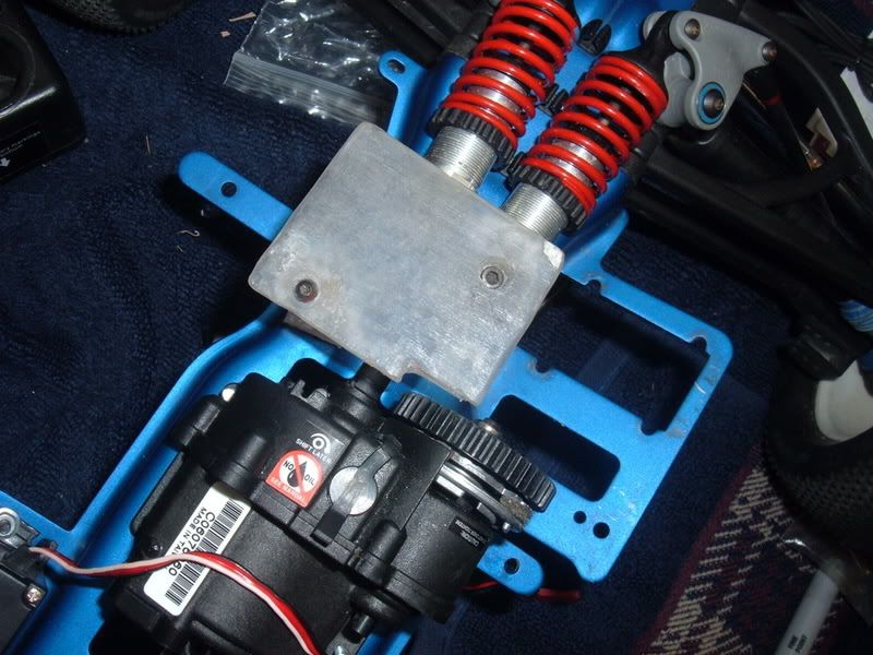

Hi guys, I got my first big 4x4 truck in a trade not to long ago. I got a revo 3.3 and im going to convert it. I will be using a MMM with a medusa 36-70 on a zippy 5s 5000 lipo. My mom ordered the lipo last night for my birthday present(perps to bring 13-14, get presents!:yipi::lol:) With my birthday money I plan to buy the motor and the RCM mount if I have enough money then the MMM. This should be a beast!:party: This is my first conversion so I need some help guys. All input accepted!:yes: here are some pics...http://i437.photobucket.com/albums/q...905-0-9992.jpghttp://i437.photobucket.com/albums/q...Picture281.jpg
this s an ESC plate I made for the MMM, its made out of 1/4in lexanhttp://i437.photobucket.com/albums/q...Picture282.jpghttp://i437.photobucket.com/albums/q...Picture283.jpghttp://i437.photobucket.com/albums/q...Picture286.jpg
Oday9513 03.02.2009 08:49 PM
wow those pics got screwed up!:oh:sorry for that guys
suicideneil 03.02.2009 08:58 PM
Host them on photobucket and resize to 800x640.
Anyways, which kv medusa did you buy, as that will determine the correct gearing and voltage you should use.
if you plan to stick with the stock tranny, then Mike (our Lord & Master) sells all you need pretty much to convert the nitro chassi over to electric (motor mount, battery tray etc) then its just a case of deciding whether you want to lock it into 2nd gear and use motor braking via the esc, or keep it 2 speed and use mech brakes.
Plenty of tutorials and info to show you whats needed either way- welcome to RCM. :smile:
Oday9513 03.02.2009 09:06 PM
Thanks! Im going to use the 2000kv one I think and im sticking with the stock trans and using the ESC brakes. Im going to buy the RCM motor mount but i think I will make a battery tray, being 13(14 in 2 weeks) i need to save all the money I can to finish the project. lol

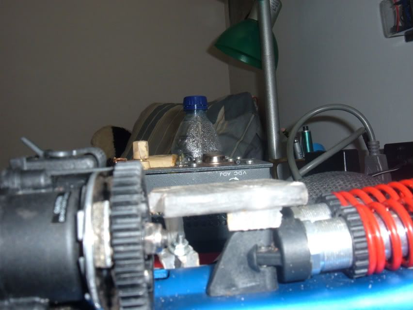

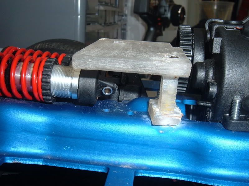

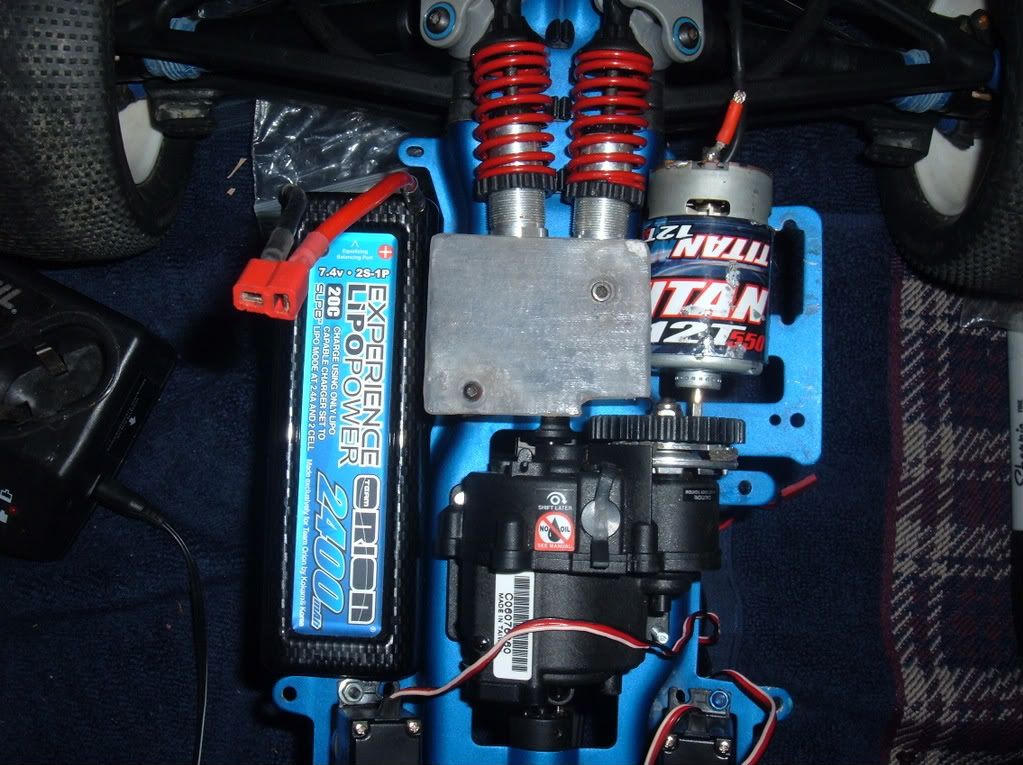

Oday9513 03.04.2009 05:15 PM

Metallover 03.04.2009 07:47 PM
That's more like it.:wink:
Oday9513 03.04.2009 07:55 PM
yeah that little marco botton really helps! what do ya think?
suicideneil 03.05.2009 07:08 PM
Crap :lol:
Nah, looks like a sound layout- not sure about the material for the esc/rc mount, but the locations are fine.
Oday9513 03.05.2009 07:11 PM
thanks, lexan is pretty tough, I think I should be fine. ok i just sold my nitro revo stuff(pipe,rx box, rx pack, throttle servo) for $30!! WOOT!!!! I might be able to buy my motor and esc next week!:party::yipi:
