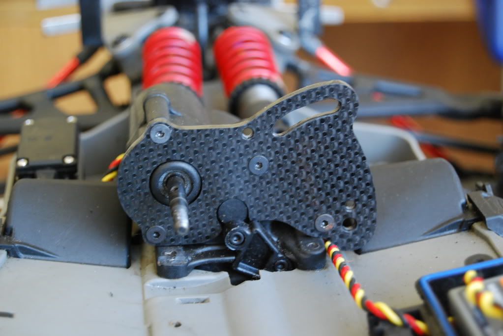

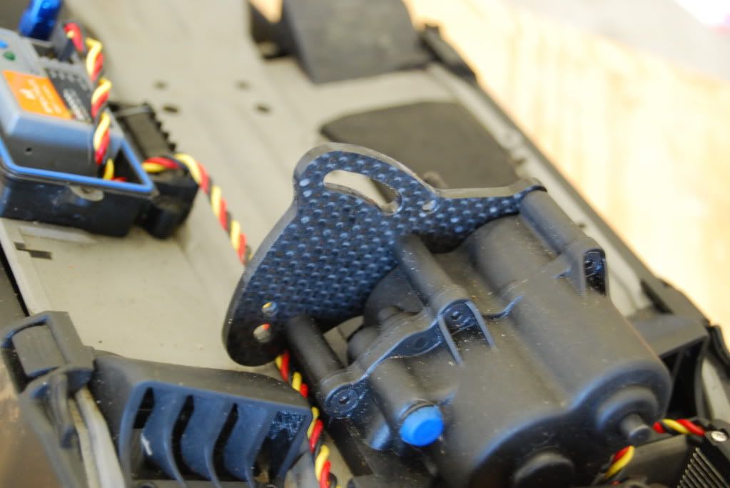

I thought i would share this with you guys, all i used to make this was a dremel with various bits. I thought it turned out pretty good for my first attempt working with carbon fiber.
Here ya go:
http://i582.photobucket.com/albums/s...1/DSC_0091.jpg
http://i582.photobucket.com/albums/s...1/DSC_0104.jpg
as you can see the carbon is a little bit thicker (and it feels quite a bit stiffer too!)
http://i582.photobucket.com/albums/s...1/DSC_0109.jpg
As you can see i still have a nit left, i need to figure out what i want to make!
http://i582.photobucket.com/albums/s...1/DSC_0112.jpg
the carbon was also a little thicker than manufacturer specs, but i see that as a good thing!
http://i582.photobucket.com/albums/s...1/DSC_0113.jpg

Cool :yes:... how long did it take you? Did you wet it down before hitting it with the dremel? Nice job man.
Alien
shizzon 05.08.2009 04:13 PM
took me probably an hour and a half total, and no i cut it dry. Thanks

OZ-RUSTLER 05.08.2009 08:45 PM
What is the weight difference between the two motor mounts?

shizzon 05.08.2009 09:05 PM
Stock was 17.4 grams, carbon version of the same mount (slightly thicker) was 10.5 grams.
E-Revonut 05.08.2009 10:08 PM
It doesn't seem like a big weight difference being about 7 grams but percentage you shaved about 35% of the weight and I'm sure it's stronger. Your also the only one that has one like it! Very nice!

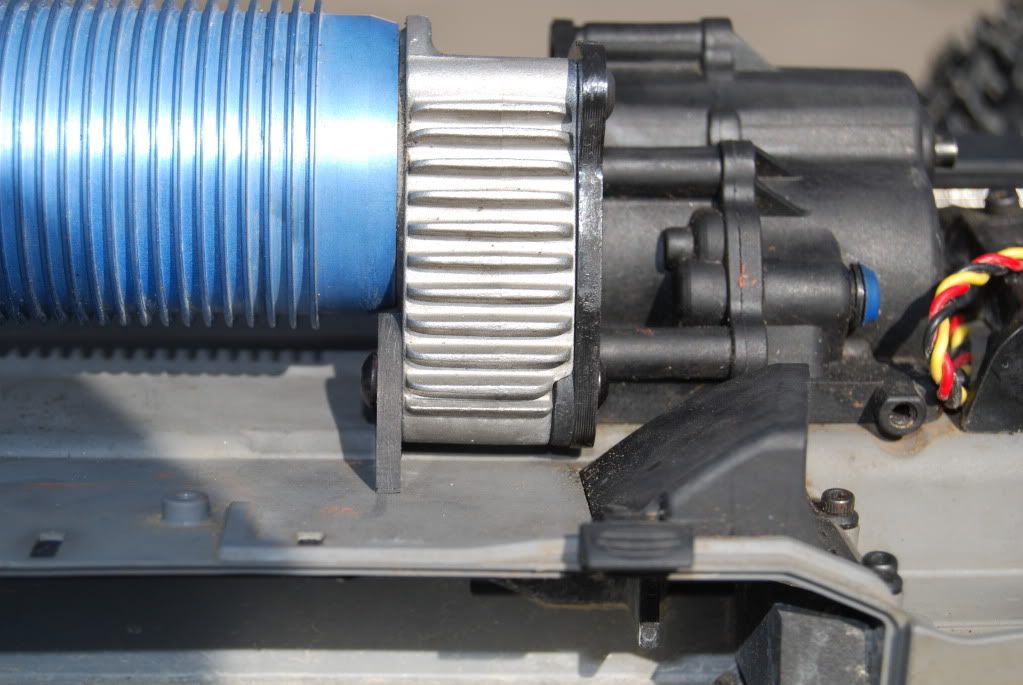

Always Dreamin 05.08.2009 10:14 PM
Well done. looks like some good work to me. Doesn't the aluminum serve as a heat sink in a way? If so, wont you lose some of that extra cooling?

shizzon 05.09.2009 02:51 PM
yes im sure the Aluminum Mount does act as a heat-sink, but the E-revo already has a designated motor heat sink. This combined with the fact that my motor runs pretty cool on the voltages it receives makes me think it should be fine. Heck, if i notice that the motor temp jumps by 30 degrees then ill put the aluminum one back on, but i dont think that tat will be the case.

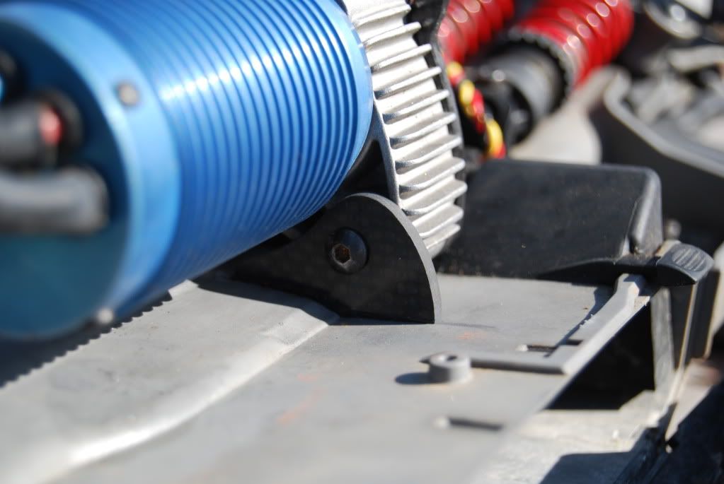

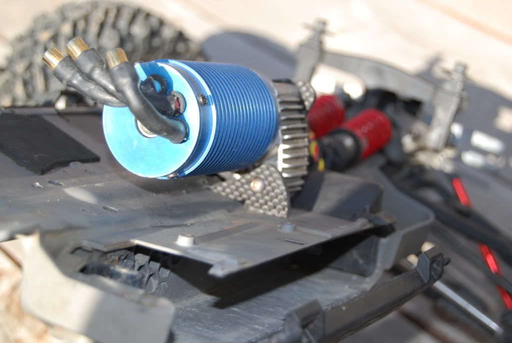

shizzon 05.09.2009 08:09 PM
Motor Mount is Finished!!
Here is my finished product, I decided that some additional support to the Motor Heatsink would help with the stiffness even more....And i was right!!! This thing is super stiff, feels like i could stand on my motor if i wanted too!!

close up of the Heatsink Brace
http://i582.photobucket.com/albums/s...1/DSC_0015.jpg
Side Shot
http://i582.photobucket.com/albums/s...1/DSC_0016.jpg
Pictures were taken before the brace was sealed on the edges with CA.
