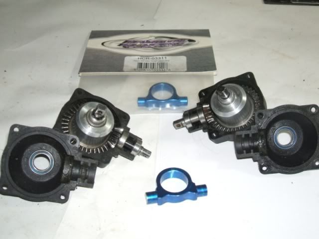

Your in the same boat as the most of us were at one time. Tearing into the diffs once a week to replace a blown diff or beveled gear. Kept doing it due to the cost of the upgrae and the stock gears were cheap. That got old fast and so did we. Not old but fast at replacing the diffs. How many of you guys out there timed how long it took you to get a diff fixed on the maxx? Was lightning fast compared to the first 2 hour differential. I was doing them in my sleep. JK I was doing them too often though, running masher 40's and endos to flip the truck forward.
I didn't have much of a problem with the internal gears once I went with the aluminum cups. Still ran into an occasional beveled gear problem though. Shimming and setting the brakes so they don't lock up on asphalt helped with that problem. It's been a long time and a lot of other differentials and parts since then. I have 35.00 a piece stuck in my head for what they cost back then. The cups were close to 20 each, the internal gear weren't anything special but you needed a ring gear that accepted the 3mm screws. That left you with the Robinson Racing ring and pinion. Which is where the other 15.00 comes into play. I was watching to see what that auction went for so I had an idea what these ones might go for.
http://i212.photobucket.com/albums/c...emaxxdiff3.jpg
Your not drooling or humping the screen are you rawfuls? I know how attractive these must look to you right now. I almost didn't post the picture but hell I couldn't resist it. First it's wow, I'd sale my soul for a set of those, then a bit of envy flows throught the viens, after that you end up a bit pissed when you realize that I'm not the only rcm brother you have that has just got these laying around with no use for them. Don't try being nice to me now. I will know what your up too. But don't worry plans have been set into motion for you. More on that later, back to rambling now...
Where was I..... End up going through differential so often you have plenty of spare parts. Enough to have working diffs just waiting to be dropped in when a problem would occur. Instead off having down time, just drop in a working one and fix the other later. Some how those two worked thier way out of the rotation.
I modified an existing ring gear to accept the larger screws on one of them. I used graphit powder to lube that one and packed the other with grease. The graphit does the job just fine and is not the mess like the grease is. Doesn't break down either. One has the RRP ring and beveled pinion.
