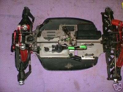

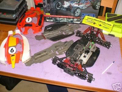

I've purchased the EB4, comes with flat chassis. Got some allu' too (250x250x5mm) to make motor and servo mount out of and I've orderd some hardened steel pinions. I've got velcro for batteries. I would use plastic battery trays from Mike but the postage to the UK was alot, just for some plastic tubs, which I can understand, sorry. I'm starting to drill out the allu for the motor mount, it is looking good! Needed to move the servo too, so it is standing vertical not horizontal, which requires me to make a new mount for it. :) Thanks, will get pictures of the finished model. |
Some pictures of the model and material and a basic idea of what I have in mind. No pictures of progress yet:
http://img.photobucket.com/albums/v2...2/7b26e463.jpg http://img.photobucket.com/albums/v2...2/361811a7.jpg http://img517.imageshack.us/img517/7540/dscn09398zr.jpg http://img502.imageshack.us/img502/342/dscn09366fe.jpg http://img410.imageshack.us/img410/6051/dscn09410sv.jpg Thanks, Nick. |
BL eb4 S3 Looks good so far..
http://img129.imageshack.us/img129/7200/dscn09523wz.jpg
http://img129.imageshack.us/img129/5765/dscn09481ot.jpg http://img128.imageshack.us/img128/6016/dscn09493wb.jpg http://img129.imageshack.us/img129/4403/dscn09501oy.jpg http://img128.imageshack.us/img128/9926/dscn09511hw.jpg Battery straps next using velcro. The shaft falls short of the spur but I'm waiting for hardened steel pinions to arrive before I adjust it some more. Thanks, Nick. |

Your buggy is getting there, Nick! Just curious, why the large servo horn ;)? If you could shave some of the CF top deck, you could move the motor plate closer to the center spur.
is black, but in the video seems blue...
It is the only one I had, lol. Yeh, plenty to work with on the motor mount, if I ever needed more space. |
