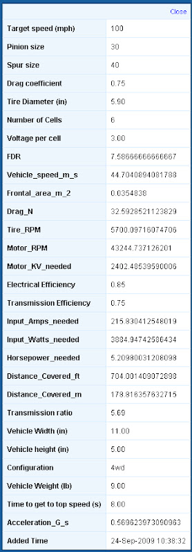

I think thats it! cool Edit it keeps giving me weird numbers I dont think it works with my setup. Unless I am doing somthing wrong.
Its the most recent 30 pinion 40 spur for my g-maxx speed build. You can see the details I believe in the table.
681 kv motor and 14022 rpm dont look right to me. Maybe I am not understanding how this works.
Whats the motor youre using? gearing is 30p/40s? what is the transmission ratio?
Ive done the calculation with all the same input as you did but I used 8 seconds to get to top speed. I got 139 amps on 6s. That seems about right.
I am using a 1515 neu 1.5 d 2700 kv on 6s. Trans ratio is 1.72 : 1. I dont understand why it says I need a 631 kv motor and on spin it ~14800 rpm . It doesnt make sense to me Obviously I am not going to run that motor and that rpm.

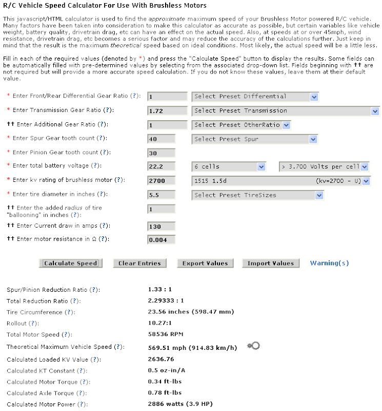

What kind of car is this? http://lh4.ggpht.com/_3N0hwXEVK9I/Sr...eedmonster.jpg |

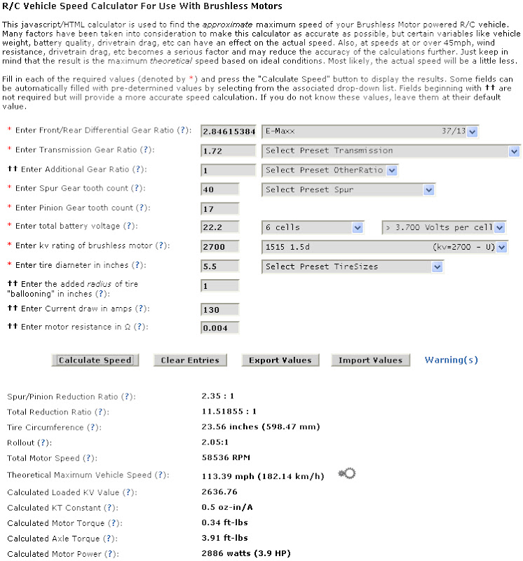

You forgot to enter the differential ratio in briangs calc . Maybe it wants total finay gear ratio instead of just the tranny ratio?
http://lh4.ggpht.com/_3N0hwXEVK9I/Sr...edmonster2.jpg |
Differential Ratio: 3.3076923076923075
Transmission Ratio: 1.7222222222222223 Other Ratio: 1 Spur Tooth Count: 40 Pinion Tooth Count: 30 Total Voltage: 19.2 Motor KV: 2700 Tire Diameter (inches): 5,5 Tire Ballooning (inches): 0 Motor Current Draw: 0 Motor Coil Resistance: 0.004 Spur/Pinion Ratio: 1.33 : 1 Total Ratio: 7.59544 : 1 Tire Circumference (inches): 15.71 inches (398.98 mm) Rollout: 2.07:1 Total Motor Speed: 51840 RPM Vehicle Speed: 101.52 mph (163.08 km/h) Effective KV Value: 2700 KT constant: 0.5 oz-in/A Motor Torque: Amperage not specified... Final Torque: Amperage not specified... Final Power: Amperage not specified... |
Ok, i see what the problem is with the results in the amperage calculator. You werent putting in the diff ratio and the transmission ratio. I'm gonna have to add an input for the diff ratio somewhere. If you take the trans ratio times the diff ratio and put that into the transmission ratio on the amp calc, it should work.
1.72*3.308=5.69 http://lh4.ggpht.com/_3N0hwXEVK9I/Sr...edmonster3.jpg |

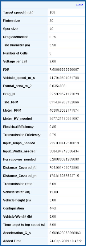

Tire diameter is too tall I am running custom made foam tires that should have no tire growth. That look more like the results I am looking for though. Thanks
So it should look like this:
Battery should output at least 200 amps. http://lh4.ggpht.com/_3N0hwXEVK9I/Sr...edmonster5.jpg |
I included the pinion and spur and just mutiplied the diff gear ratio x the tranny ratio and came up with the same numbers. Looks good now.

If I step up the spur to a 42 the motor kv are right on the money. Is it true 4000 watts are needed and over 5 hp . Is the motor even capable of that? I believe the peak is 2700 watts.
Target speed (mph) 100 Pinion size 30 Spur size 42 Drag coefficient 0.65 Tire Diameter (in) 5.50 Number of Cells 6 Voltage per cell 3.00 FDR 7.938 Vehicle_speed_m_s 44.7040894081788 Frontal_area_m_2 0.04967732 Drag_N 39.545993896358 Tire_RPM 6114.64968152866 Motor_RPM 48538.0891719745 Motor_KV_needed 2696.56050955414 Electrical Efficiency 0.85 Transmission Efficiency 0.75 Input_Amps_needed 225.147173346343 Input_Watts_needed 4052.64912023417 Horsepower_needed 5.43469198856744 Distance_Covered_ft 880.001761341123 Distance_Covered_m 223.520447040894 Transmission ratio 5.67 Vehicle Width (in) 11.00 Vehicle height (in) 7.00 Configuration 4wd Vehicle Weight (lb) 9.00 Time to get to top speed (s) 10.00 Acceleration_G_s 0.455699178472771 Added Time 24-Sep-2009 10:58:32 |
