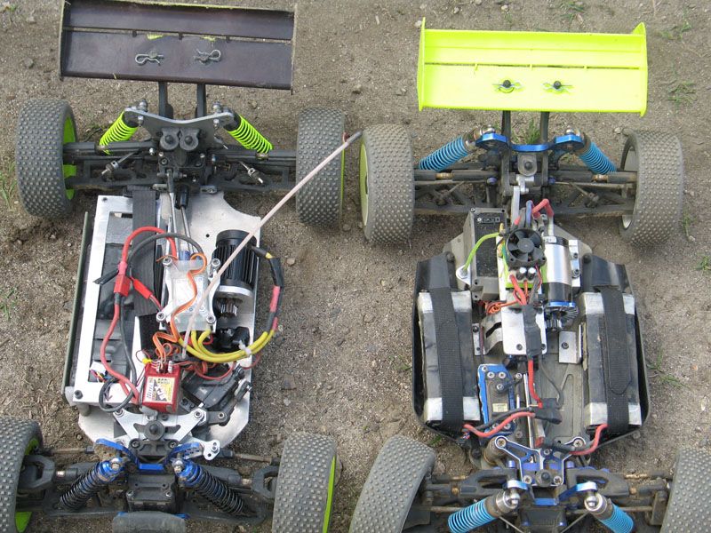

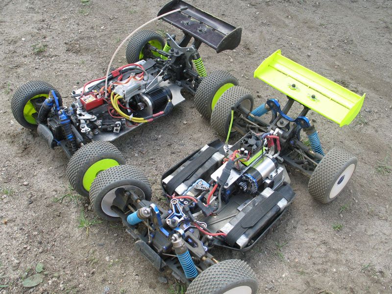

cspurlock 03.22.2006 11:57 AM
2 Attachment(s)
Here are some pics of my K3 and the Mayhem I am working on:
MetalMan 03.22.2006 10:03 PM
Some more pics (it's the K3, right?), side by side with my electric X-Terminator:

Sylvester 03.22.2006 10:10 PM
Some VERY nice buggies.
