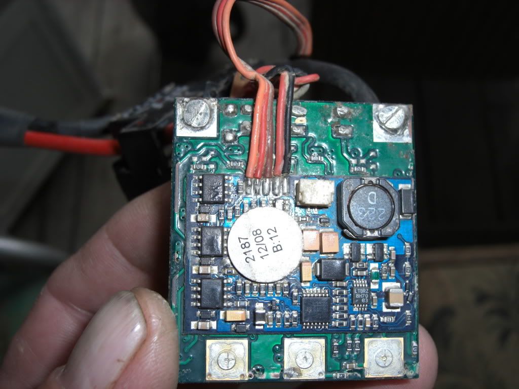

Kinda hard to see if anything looks obvious from the darkish picture, but things look ok except maybe the discoloring on the BEC coil, but that could be natural or just dirty. Maybe the BEC died? You can check that with a voltmeter.

1 Attachment(s)
Is it me, or is there a component missing right there???
BrianG 04.28.2010 03:54 PM
Yup, looks like there is a component missing. The only decent picture (pay no attention to the arrow/circles) I have of that area doesn't show the value though.

@ Brian, will take a better pic tomorrow. No idea where the BEC is located, will go search for that now :)
@ What's_nitro?, damn, even with the picture of Brian it took me time to find that thingy is missing...

The bec coil is that large black square component with the circle in the middle- you can test it by hooking up the esc to a battery & rx, then test the voltage coming from the rx or throttle lead pins. If you dont get lights on the esc when you give it throttle input then the esc is fubar ( same as no bec output voltage = fubar ).
