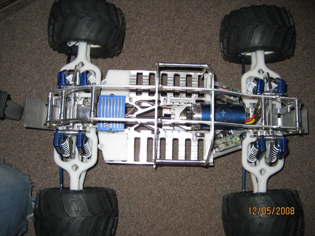

1 Attachment(s)
here is a teaser of the truck... i'm just waiting on shocks, but other than this the entire truck is 90 % NEW. The only thing not new are the UE Setbacks. They are mint but still not new. All the other UE parts are new and either in the package still or what you see on the truck. The center diff plate can accomidate any spurs between 50t-44t. The bottom plate will be made available to peeps. Trust me this is SICk!!!
Just one teaser pic for now. I'm going away on vacation so i can't show it off. Sorry guys, but i will once i return.
Kcaz25 07.07.2010 04:40 PM
You are going to love racing this truck! I'm excited for you! Do the batteries right!
_paralyzed_ 07.07.2010 05:04 PM
spin that diff, face the motor forward for better weight distribution.
Looks sick!!!!!!!!
suicideneil 07.07.2010 07:42 PM
Niiice, strobe braces ftw :yes:
respirologyrc 07.07.2010 08:59 PM
Here is what i have in the truck:
UE 6 spyder diffs
UE alum turnbuckles
UE RcX
UE 6mm CVD's
UE Knuckle Heads
UE Ti Pillow Balls
UE Servo Saver Gen 4
Strobe front and rear braces
RC Monster CD
Dave Wing Mount
14.8v 3000mah 35C batteries ( one on each side so a total mah of 6000)
Proline Bull Dog body
Tony Screws
Avid Ceramic Bearings
I will have to see what else.

_paralyzed_ 07.08.2010 03:58 AM
Originally Posted by respirologyrc (Post 372510)
I intend on running this with truggies.
I really think you'll want to spin the cd 180 degrees and have the motor face forward if you plan on racing. It should be as simple as unscrewing the cd and spinning it.
I figure 30,000 wt oil in the cd is a good starting point....

We need to know what tires you will be running to suggest a pinion. They are buggy diffs! UE just renamed ofna diffs and called them "Super 6 and Super 8"
Originally Posted by respirologyrc (Post 372565)
30k in the middle?? I was going to try a more traditional 7k front, 10k middle, 3k rear. What makes you say 30k center? just curious. I've been racing for 5 years and am pretty decent at the clubman level.
I have a heavy e-maxx with a CD and less than 30k unloaded quite a bit to the front. Turning the CD so the motor faced forward helped that and made jumping much more manageable. I guess whatever truggies are using in the CD should work. I have never raced.....
