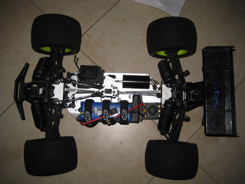

MiamizFinest 06.15.2010 04:09 PM
Cleanest E-Muggy On RCM!!!
Just wanted to post a few pics of my E-MUGGY with out the lid, i finished her up this weekend and tested her out and all i can say is she is quick, im running 2200KV on 6S i was gear much much lower to work with the HPI phatlines but those phatlines just can't handle the speed they blew off very easily which kinda sucks. So i could test it out further i slapped on some GRP 8th scale buggy wheels and geared up.... no one was around with the radar gun but i know this thing was pushing into the 70's with the smaller wheels on it.
Anyways enjoy the pics!!
http://i124.photobucket.com/albums/p...7/P1010035.jpg
http://i124.photobucket.com/albums/p...7/P1010034.jpg
http://i124.photobucket.com/albums/p...P1010031-1.jpg
Anyone one know some truck size tires that don't balloon to hell and rip apart?!?!
nuz69 06.15.2010 04:28 PM
What the hell is this pinion gear in this heavy truck ^^ :lol::lol::lol:
35T ? :D
Don't forget to check the temps :angel::angel:

I started with a 16T pinion on with the phatlines but again the wheels sucked, SO i moved to 8th scale buggy wheels and put in a 25T pinion to break even. That heavy puppy was hauling ASS. I put the phatlines back on for the pics but i will not be using that jumbo gear with those big tires , BUT the gear is working well with the buggy wheels. For now anyways until i find a better wheel.

bryan 06.15.2010 04:51 PM
Looks great , im getting some things together to convert my sons.That looks like a losi 8ight tray your using? How much did you have to do to the chassis to make it work "extra holes" ?

MiamizFinest 06.15.2010 05:03 PM
for the battery tray nothing was drilled the rear holes lined up fine with the motor mount holes in the chassis. The front hole ALMOST lines up with a hole already in the chassis its about 2MM off but with a 4MM screw threw the hole not only does it clear the hole perfectly it threads itself into the tray on its way up. All in all i only added one hole to the chassis and that was for the radiobox. Pretty simple and clean. I used the ofna radio box for a factory look.
