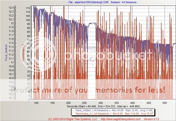

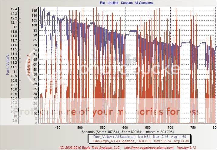

asheck 03.24.2011 05:10 PM
This is not the same setup as the above graphs. It's my Slash 4x4 1415 with a SV2 Pro, :lol: I added a cap and bec, radared at 45mph. Also I wasn't near as consistent with the driving on the 5, you can see the 0 had more steady runtime. So if you take out the down time, it had a higher average. I also did not run the same battery in each, but they are matching packs, I'm gonna switch them around, and try to be more consistent.
5* timing
http://i531.photobucket.com/albums/d...ming545mph.jpg
0*
http://i531.photobucket.com/albums/d...43stiming0.jpg
Temps were within a few degees of each other, and the 5* felt better. Pulled a few wheelies with it, couldn't on the 0.
snellemin 03.24.2011 06:07 PM
So would you say that 5 degrees of timing is most efficient in your setup?
asheck 03.24.2011 06:35 PM
At the moment, I don't believe I'm educated enough to say. :) I can say, that the 5 timing sure seems to have more power then the 0, and had higher amp spikes , so it would seem that efficiency would be hard to determine, due to different performance.
But I'm doing another run, and it's more confusing. Geared down to 17/54, and pulled 119 amps. WHY!! :)

You might of have some cat hair in between the gear mesh, causing the increased friction. Hence the higher amp draw.
Maybe you had more traction at one point. Was your avg ampdraw about the same or less?

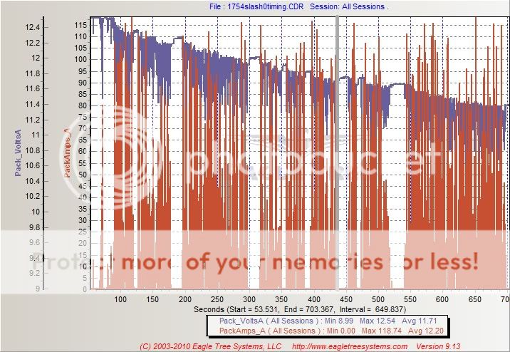

asheck 03.24.2011 07:07 PM
17/ 54 gearing 0 timing , same battery for both runs, performance was very close.
http://i531.photobucket.com/albums/d...7540timing.jpg
5 timing.
http://i531.photobucket.com/albums/d...slash17545.jpg
Take from it what you can :)
You know I am learning, more then max, it is all about the averages.
snellemin 03.24.2011 07:13 PM
I have a theory. Lower gearing produces more instant torque, which you can see by the peak reading. Lower gearing also equals to a lower load on the motor, hence the lower avg reading.
Just a Tomballion theory.
nuz69 03.24.2011 07:22 PM
I always have longer run times with my 1520/1Y on 4S in my buggy than my 1515/1Y on 4S both setup geared for the same speed. I can't explain why you found the contrary with your results ^^
But it's true that cool does not mean efficient.
asheck 03.24.2011 07:30 PM
Are they geared for the same speed, or running the same speed? I always confirm speed, just in case.
Could be. I've seen lot's of stuff with the datalogger, that I haven't worked out yet. Especially when it comes to bursts.
