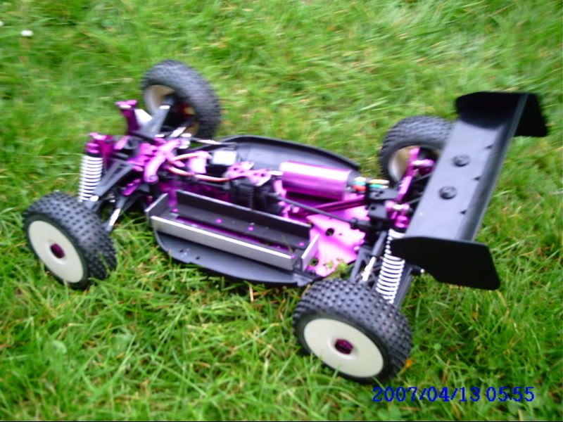

nativepaul 04.13.2007 05:02 PM
Getting a little closer now, I put ball races in the steering and fitted the servo.
I re-formated my 12cell pack, I made up a battery tray from alloy angle section lined it with foam and cut some carbon tube chassis standoffs, but I'm waiting for longer bolts to fit it.
Just an order from RCMonster and it will be runable, then the bodywork starts.
Some more Pics for you.
http://i22.photobucket.com/albums/b3...Picture023.jpg
The battery tray.
http://i22.photobucket.com/albums/b3...Picture024.jpg
In position.
http://i22.photobucket.com/albums/b3...Picture020.jpg
Looking a lot less bare than it used to.
http://i22.photobucket.com/albums/b3...Picture026.jpg
everything but the body, spur pinion, motor mount, mamba max and ubec.
BrianG 04.13.2007 05:05 PM
While I don't generally like purple, that color contrasted with black does look nice. But, you gotta color your batteries though - blue clashes. :)

nativepaul 04.13.2007 06:37 PM
Your right about the battery heatshrink it does look wrong, but the only other heatshrink I have is either clear (and the cells are wild multicolour underneath)
or florescent pink.
I like the black and purple as well, and the red on the body clashes. I'm half tempted to strip the body and paint it black with a pair of purple stripes down the middle like the stripes down a ford GT40. I have a set of black road wheels for it allready and with a set of black springs I think it would look awesome (if theres a good body paint match for purple anodizing, anyone know?).
But a set of springs and 2 cans of paint goes against my budget and it will be hidden most of the time anyway, I was planing on my oft used black and gold scheme for the scale body, but maybe purple/black and I have enough left over to do the inner body too.
nativepaul 04.13.2007 06:54 PM
Ehe Brian, thats not a mis-type on the thead title, I did mean scale 1/8th buggy not 1/8th scale buggy, truggy boddies are way too narrrow to get the wheels inside the arches.:007:
I will be making a badass bowler style racing landrover body to go over the whole buggy for a full scale look, although caricature scale due to streched width and probably lower height.
