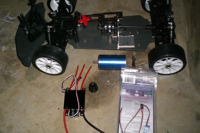

tashpop 02.08.2008 10:01 PM
some pics i know i'm missing the front drive shaft in one of the pics. i have to pull the center diff out again and install it and my break disc.
http://i39.photobucket.com/albums/e1...ure73109-1.jpg
http://i39.photobucket.com/albums/e1...cture73110.jpg
http://i39.photobucket.com/albums/e1...cture73111.jpg

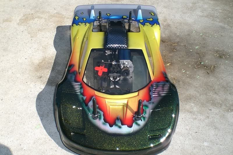

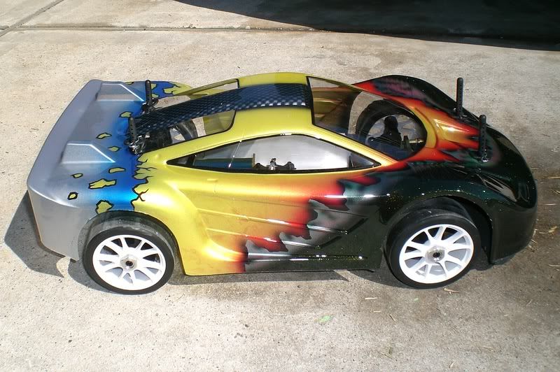

tashpop 02.10.2008 09:28 PM
got some progress done today. i was hoping to get it finished this weekend, but i had to work saturday, so i lost a complete day.
first up, body is painted. it didn't turn out like i wanted it to. i didn't know what to expect with the color on the front, and i think it throws it off a little. i'm always hard on my painting though.
http://i39.photobucket.com/albums/e1...cture73112.jpg
http://i39.photobucket.com/albums/e1...cture73113.jpg
http://i39.photobucket.com/albums/e1...cture73114.jpg

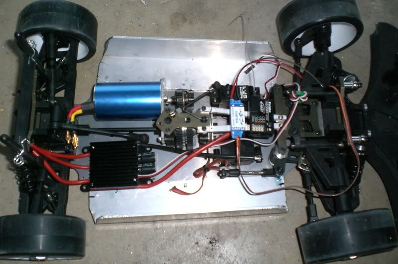

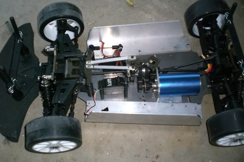

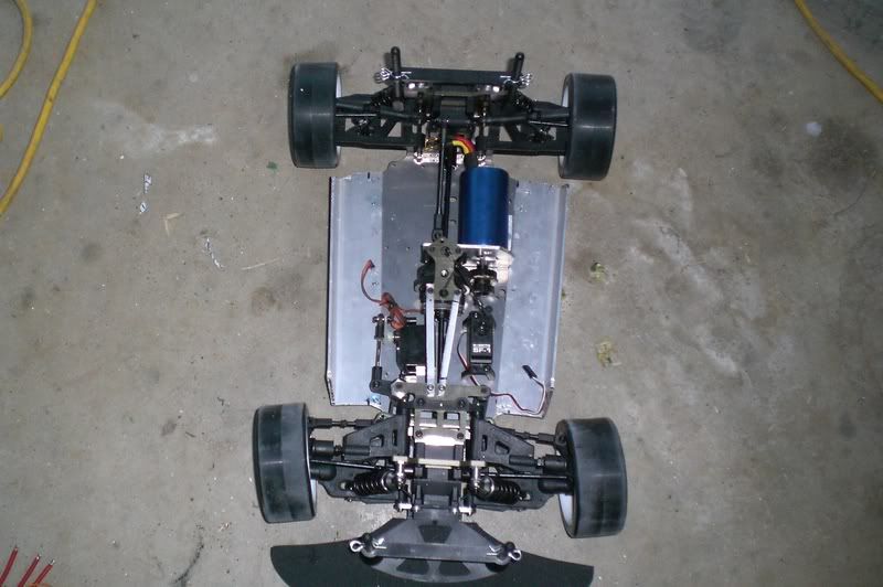

tashpop 02.10.2008 09:37 PM
now for the insides. i moved my servos around a little, flipped the break to the front, mounted the motor, got the battery trays on, and made some small peices to tie the center to the front. i'm thinking about making a mount on those peices to place my reciever and bec. everything is rough at this point, and i also plan on putting some holes on the battery trays to lighten them up some.
http://i39.photobucket.com/albums/e1...cture73120.jpg
http://i39.photobucket.com/albums/e1...cture73116.jpg
http://i39.photobucket.com/albums/e1...cture73115.jpg
here is the layout im thinking for now.
http://i39.photobucket.com/albums/e1...cture73118.jpg

That is a good paintjob man. The white rims are setting it off a bit, if that is a fault you are trying to see.
That will be a screamer down the track and lots of OOH's and AAAAH's at the next TNT.

i agree about the wheels, i'm thinking something gray, black, or yellow would fit it better.
