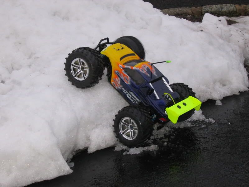

Setup is a LMT 1920/10, MM, Align 3S 2100 20C lipo, 14/46 gears riding on the CRT pro kit w/ the ofna ext chassis. Weighs 2020g with the heavier 1:10 scale road rages pictured below (was a temp setup waiting for other tires to come in). Weighs 1900g w/ the buggy dirthogs & proline rims inc w/ the kit. That's lid, batt and all. The goal was a lightweight truck as a part time basher/racer. Drives absolutely wonderful and makes the Revo look like a slog in comparison.

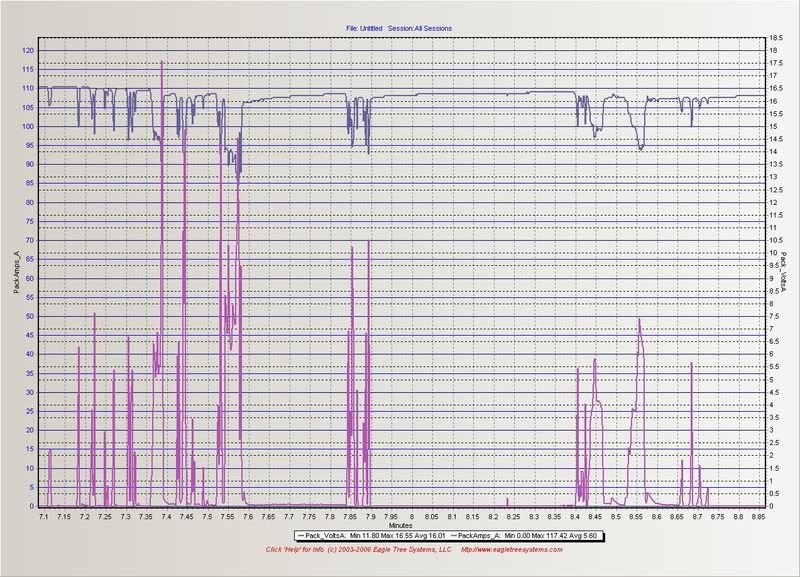

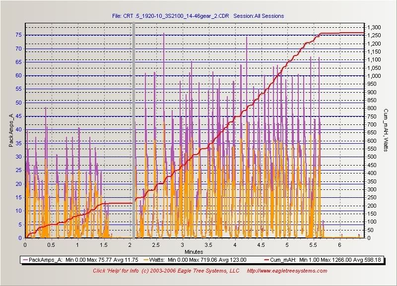

Nevermind the mismatched tires below in the topless pic. It was just for testing. Also, notice the huge amp spikes in the 1st graph. I'm not sure how accurate they are, but I turned down the punch control one step for the 2nd session. Since there is no slipper, no limiter is very hard on the driveline. The actual performance loss is not really noticeable. Calmed down the huge spikes tho, and the batt is getting nearly so hot (no wonder.)

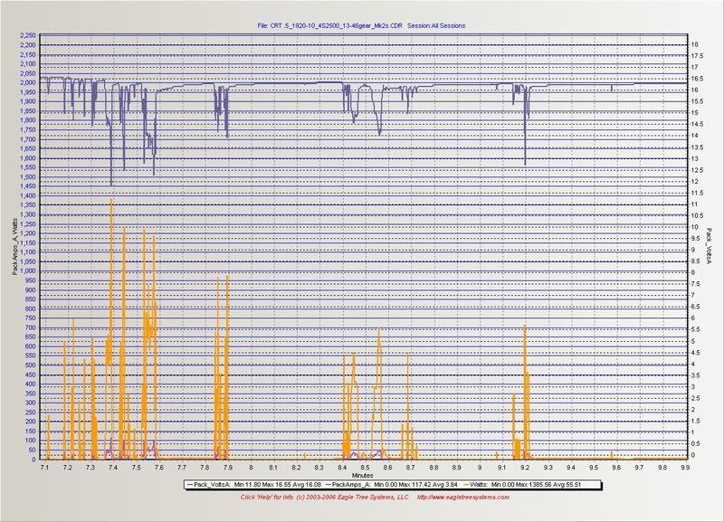

Here are some more ET data shots. These are the Neu batts. The first is the 3S 30C 2500 pack (14/46 gear), the 2nd is the 4S 30C 2500 pack (13/46). Both are with the big mashers on. The 4S pack doesn't have much data as the fracking kingpin bushing came out after I back flipped it at 40 something mph and skidded down the road. I drove it around for a little bit with the wheel flopping around, but had to end it early. It was on the run where I pulled nearly 1400W, but that power just sent the CRT on its lid. We'll have to work on it a bit, I really want to be able to hit 60mph. It'll have to be on the buggy wheels and with lots of luck tho. The runs on the 3S pack are clocking in at 46mph.

http://i7.photobucket.com/albums/y25...erswattage.jpg
