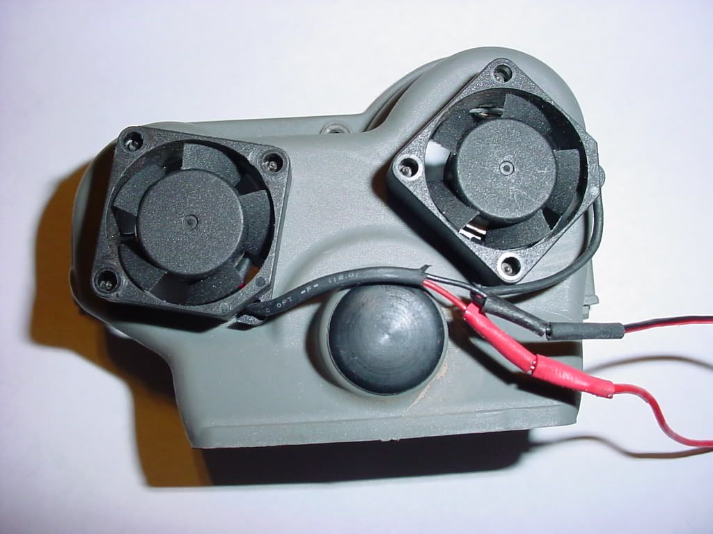

I tried my E maxx on 5S yesterday. It ran GREAT. Lots of power and temps were ok. Well at least for the first half of the pack.
Then the motor began to get hot. The longer I ran it, the hotter it got. It got hot enough I couldn't hold my hand on it, and at one point I could even smell it. UH OH.
I really like this setup on 5S. I noticed the motor mount gets as hot as the motor does. Being aluminum, it is pulling heat from the motor and also the slipper clutch assembly.
Here's my attempt at additional cooling. 2 - 25mm 5v fans @ 1.3cfm each. I will power this with 6 volt off the CC BEC.
http://i160.photobucket.com/albums/t...m/DSC06830.jpg
http://i160.photobucket.com/albums/t...m/DSC06831.jpg
http://i160.photobucket.com/albums/t...m/DSC06828.jpg
t-maxxracer32 02.17.2008 05:53 PM
thas pretty creative.
very smart.
if it works.
would gearing it diff help with the heat issues?
or is it just too much volts for the motor?

sikeston34m 02.17.2008 06:15 PM
very smart.
if it works.
Hi T maxx,
Well thanks.
Ummm, yes and yes. LOL This motor isn't rated for this many volts, But I feel like 5S is right at the limit for this setup. By providing some additional cooling, I hope to swing temps back the other way.
I could gear down, but things are in the fun zone now! LOL
This setup rocks on 4S with temps staying in check, but is even better on 5S. :great:

Well I got the fans all hooked up to the BEC.
I'll try it again tomorrow on 5S if the weather works with me here.
All rainy here. :whistle:

Why not use these? http://search.digikey.com/scripts/Dk...me=259-1325-ND They are pricey at $11.42 but they put out 3.5cfm which would triple what you have now...
