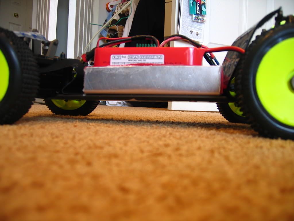

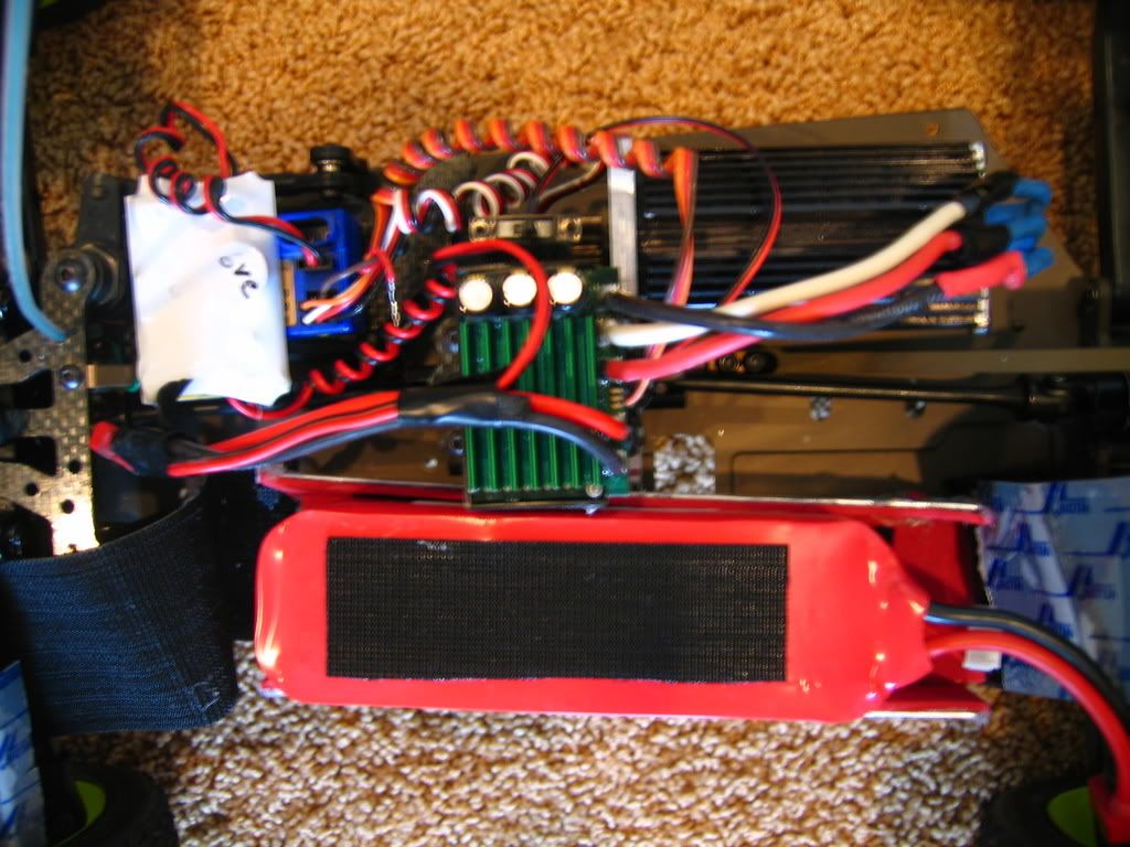

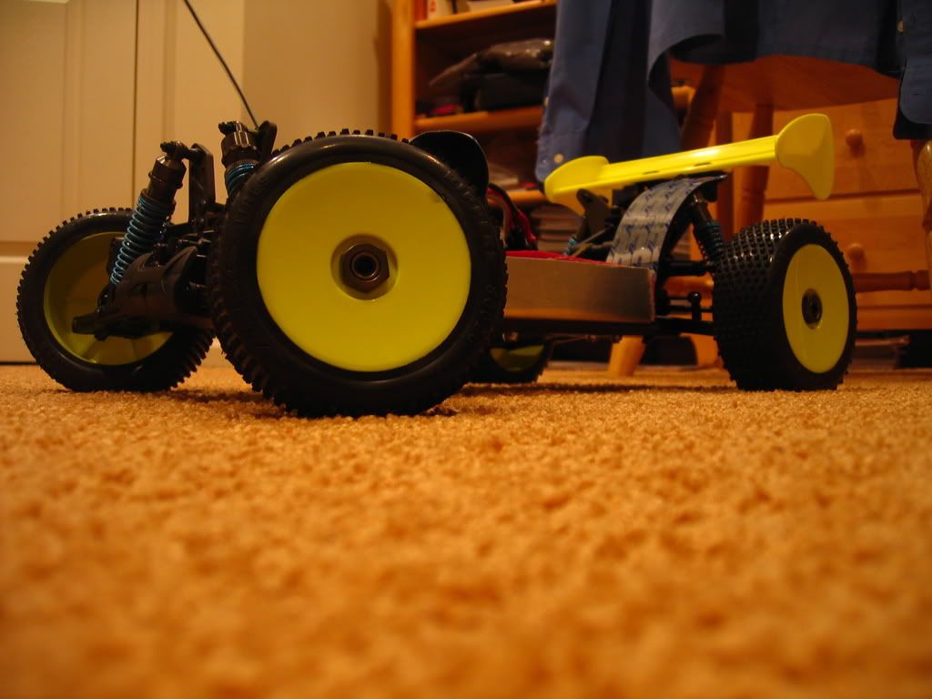

Here she is. The goal was to keep the cg as low as possible with the main focus being keeping everything close to the center. I'm very happy with how it turned out. Don't even need mud gaurds! Only thing that's high is the esc.

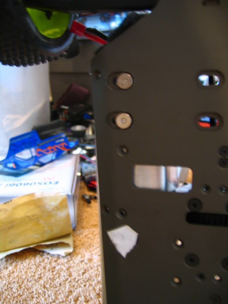

Here's the sweet battery box me and my buddy made in the shop at school:

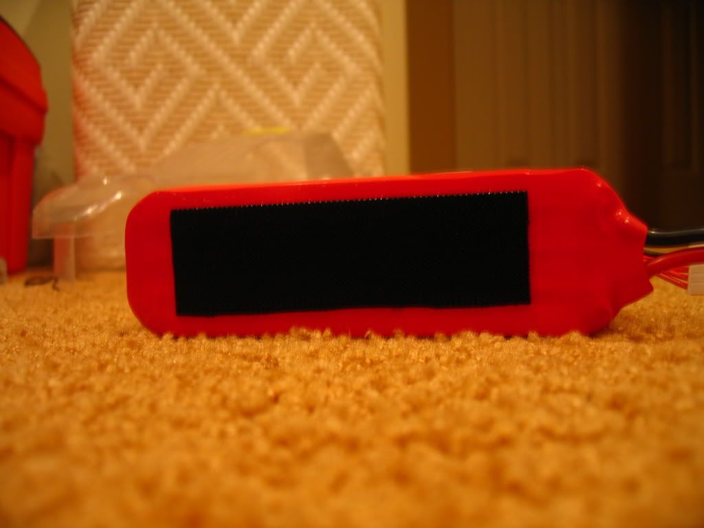

Velcroed the batt so don't comment about the two on top not being enough :wink:

Use some ordinary 3mm nuts with locktite rather than lock nuts.
Then take a dremmel to them to make it flat. Cheers
supralover72 03.14.2008 11:27 PM
I would if I had either of those, lol. Thanks for the tip though :smile:
dezfan 03.14.2008 11:27 PM
Aren't you worried about those Nylock bolts hanging below the chassis catching on something?
supralover72 03.14.2008 11:30 PM
Yea, but I have no other way of holding down the batt tray, so it is what it is.
lincpimp 03.14.2008 11:43 PM

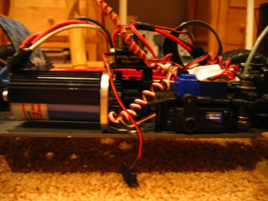

Time to invest in a m4 tap and thread the chassis so that you do not need nuts. Also swap the esc and receiver, that will lower the cog without moving much weight away from the center line. And shorten all wires, including signal wires to the bare minimun. You would be suprised how much wire weighs! And put the rcm heatsink on its side, and you can open a hole in the body to flow air past the motor, rather than over it. Otherwise it looks good
supralover72 03.14.2008 11:47 PM
Thanks for the tips linc! I'll look into the tap. Can't swap the esc and reciever since the wires aren't long enough and I don't feel like extending them. And, my soldering iron is terrible and it'd be a hassle to shorten the wires, so I'm skipping that. About the heatsink on it's side, I don't want a hole in the body since it's a basher and all kinds of crap could just fly in.

Update: Fixed the bolts hangin out. Just flipped them and added3 or 4 more layers of foam with cutouts for the bolts in half.

how is the velcro attached to the body? is it just stuck on, or screwed on?

The velco is screwed on.
