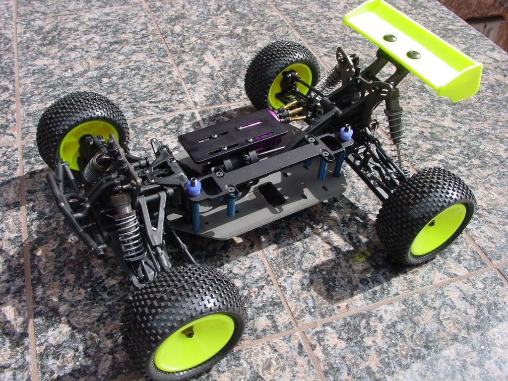

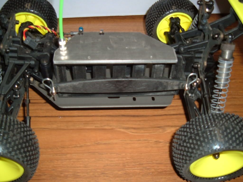

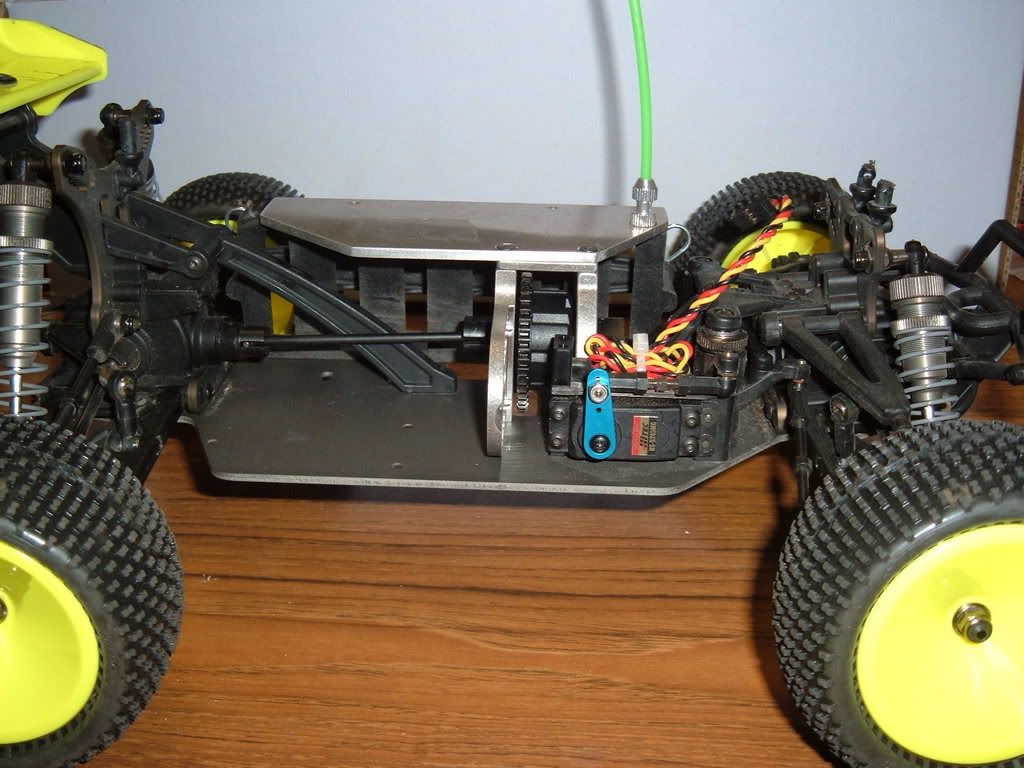

I did a stock chassis .5 a while ago, heres a few pics of how I did it:
http://i206.photobucket.com/albums/b...p/DSCF1540.jpg
http://i206.photobucket.com/albums/b...p/DSCF1541.jpg

Mine, with stock chassis but home-made tray, mount, etc:
http://scriptasylum.com/bl_conversio...es/crtp5_2.jpg
http://scriptasylum.com/bl_conversio...es/crtp5_4.jpg
