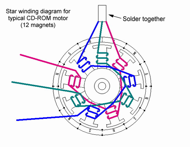

2 Attachment(s)
Here is a very simplistic picture that gets to the point on how they are wired internally
