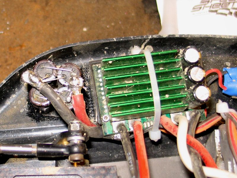

To do the cap mod. you need 4 of these (cause 4 smaller ones are better then one big one)
http://search.digikey.com/scripts/Dk...me=493-1866-ND
35v 330uf, low ESR.
then you solder them so all the negatives go to the black wire, and positive to the red wire.
Thanks to metal man for describing this al to me:
http://img.photobucket.com/albums/v1...e/IMG_6918.jpg
