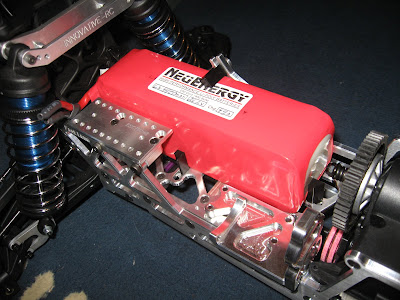

So here is a picture of my new battery :yipi: installed in the FLM savage.
http://lh4.google.com.au/MTBikerTim/...G_1152.JPG.jpg
My question is, are those delrin stops going to be enough to hold the battery? This truck is going to get beaten and I am just wondering if those stops are going to damage the battery in a big hit. The battery is in there fairly tight so I think it might be OK but I don't want to wreck an expensive battery.

cemetery gates 04.01.2008 05:49 PM
Well, to let you know, on my savage after a nose down landing at the track I proceeded to put a nice dent in my 4s 8Ah TrueRc lipo from the small delrin stop in the front. I have since put a piece of angle aluminum the width of the battery where the front battery stop is to distribute the shock of nose down landings across the front of the battery(instead of focused on one small point). I also put some foam on the front of the battery to help with crashes. I just hope I didn't ruin my battery(but it is a perfect reason to move up to 5 or 6s!):mdr:

MTBikerTim 04.01.2008 05:59 PM
That's exactly what I wanted to hear (experience). Thanks cemetry gates. I might see if I can get some bigger stops made up then. I hope it hasn't damaged your battery.
lincpimp 04.01.2008 06:00 PM
I have the same concern with my savage flm conversion. I plan to make a partial tray out of delrin to protect the ends and open side, and keep the pack in place. I will also use some velcro straps to hold the battery in the box.
I had a good look at the spacers and decided not to use them. They look ok, but I do not trust that they will keep the battery off the spur gear.

legobrains 04.01.2008 07:06 PM
If you wanted to do it a cheap way. Buy a sheet of lexan like this:
http://www3.towerhobbies.com/cgi-bin...?&I=LXGGW3&P=7
and then use a hair dryer and scissors to mold it around your battery. They you can wrap the whole battery in lexan, and protect it from a lot of stuff.

lincpimp 04.01.2008 09:13 PM
Originally Posted by MTBikerTim (Post 159770)
I like this idea. Is the 1.5mm 0.06" stuff going to be thick enough to protect the battery from impacts? http://www3.towerhobbies.com/cgi-bin...?&I=LXGGW4&P=7
This is what I will do with the sheet kydex (said delrin, meant kydex!). I will make a 4 sided box, and use the left side chassis rail as the 5th side (6th side is the open top). That will maximize the battery area, as it is a bit narrow, but still leep the pack safe.

lincpimp 04.02.2008 10:01 AM
As soon as I get motivated to continue with the flm savage I will take some pics and make a tray.
