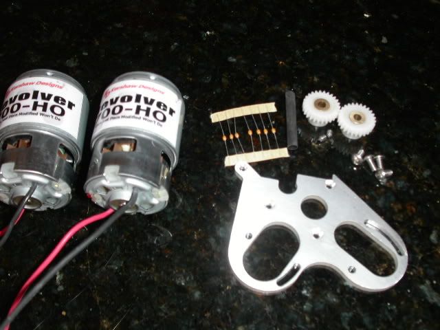

Ok I just got the kershaw kit and it came with capacitors and says to solder them on ....I will put them on then...it says to run them in water to break in, does everyone do this with brushed motors ?
http://i126.photobucket.com/albums/p...a/PICT0064.jpg

Never heard about running in water??? I usually just hook the motor to 2 d-cell batteries (3 volts), and let em run till the battery dies. You can do the same thing if your charger has motor run feature, set to 3 volts and run a while (until brushes are seated).
