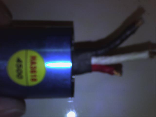

speed demon 04.09.2008 02:19 PM
1 Attachment(s)
Well live and learn I guess. Glad I only paid 30 bucks for it. Here is a pic and I'll see if some acid will work. The reason why I cut them was because I needed long leads. I desoldered the bullit connectors that came with it and tried to butt solder some extensions on to be able to reach my speed control. I thought I had it good but when I went to run the motor it was clogging very badly. I figured it was just not a good connection and that's when I bought the 4mm bullits and cut the wires.
Arct1k 04.09.2008 02:22 PM
You could try this:
http://www.bavaria-direct.co.za/models/faq.htm
How to strip the enamel coating off copper wire
Burn off the coating with a cigarette lighter or better still, a pencil torch. A heatsink will help avoid burning the wire back too far. It's like a thin alluminium clothes peg. Electronic supply stores may still have theml.
Burn the wires about 1cm back. Hold the bunch of wires flat over the edge of a table and rub with an ink rubber (eraser) to remove most of the remaining carbonated coating.
Use Bakers Fluid (from a hardware store, for soldering galv gutters etc,) on a cotton ear bud. This rips off any oxide when heated with a dry soldering iron tip.
Tin with solder.
