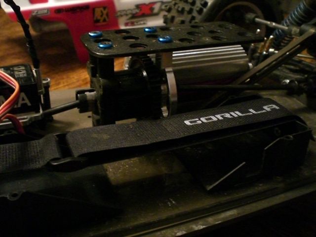

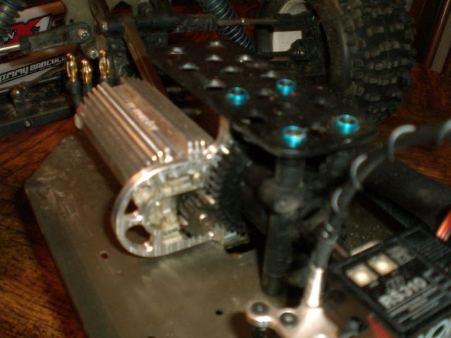

Do you have any pics of your conversion?
Jammin 04.12.2008 07:36 PM
2 Attachment(s)
http://www.rc-monster.com/forum/showthread.php?t=10965
