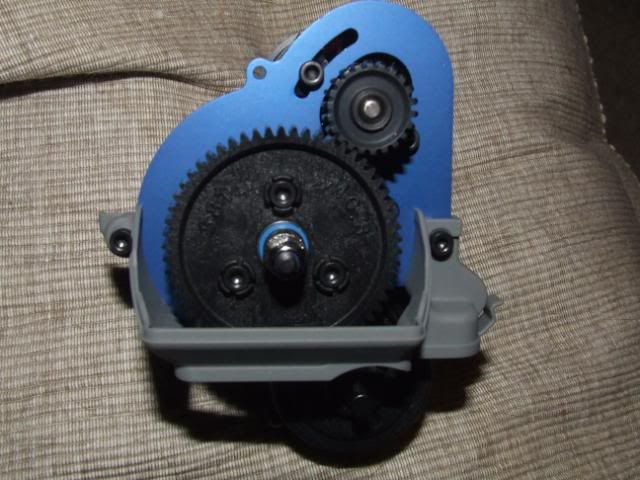

here is a pic of a 1515/1y in a 3905 just to show you gearing options shouldnt be a problem as far as clearance goes. thats a 58 stock spur and 22t pin

lincpimp 04.13.2008 09:00 PM
Stock spur is a 68.
jayjay283 04.13.2008 09:04 PM
sorry I meant the spur is from Traxxas' stock, Its a jato spur #3958 direct fit
lincpimp 04.13.2008 09:07 PM
Makes sense! Thanks.

I don't know about the 3905 motor mount but a 3906 can only fit a 51/20 without modifying the mounting plate. The neu can is pretty large compared to Titans. May some one else can be more specific about the 3905.
