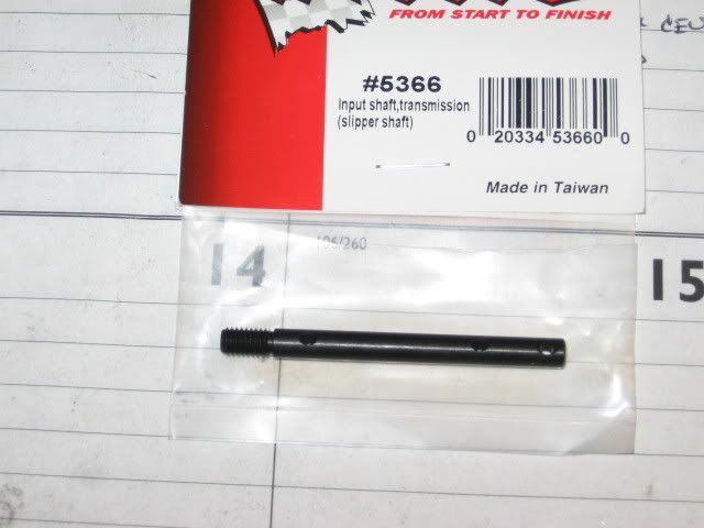

How to modify the output shaft of a Revo to accomdate the 3905 slipper clutch system for a Gmaxx G1 single speed or FLM 10000 single speed transmission.
Parts you will need!
1. Revo output shaft / Part # 5366
2. Traxxas second gear from a 3906 trans / Part #3933
3. Traxxas slipper clutch system part #5351 & 5352x
4. Spur Gear (your choice of stock or Mod 1)
Equipment you will need!
1. Drill press
2. Titanium Drill bit 5/64”
3. Bench grinder

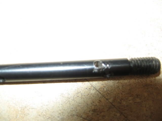

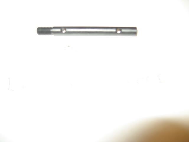

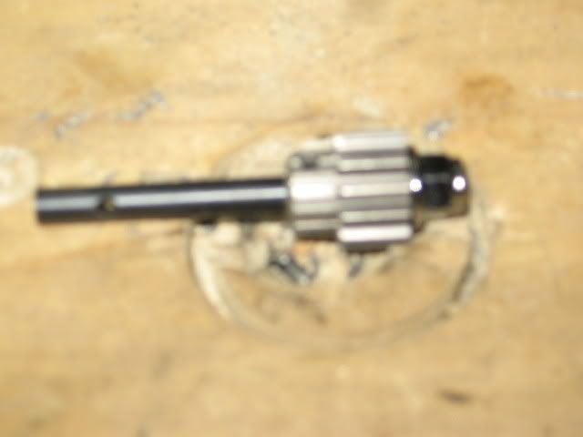

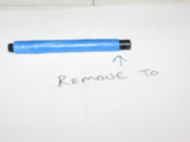

Take out your new output shaft and use tape to as a guide, you will need to grind down the end of the shaft just below the end hole. See pictures below

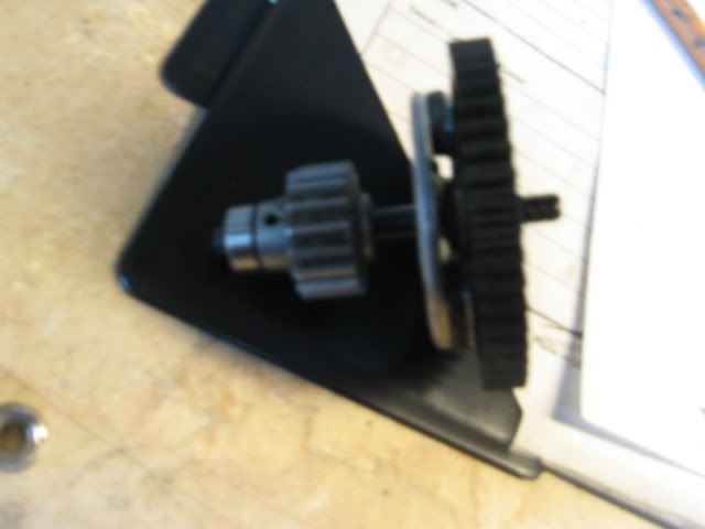

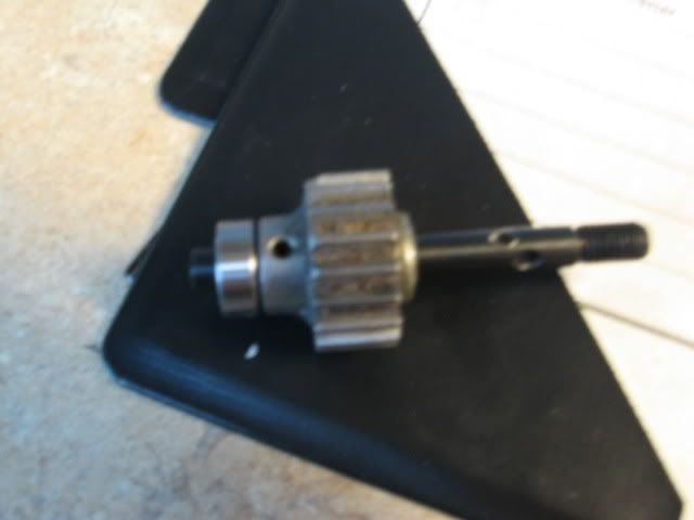

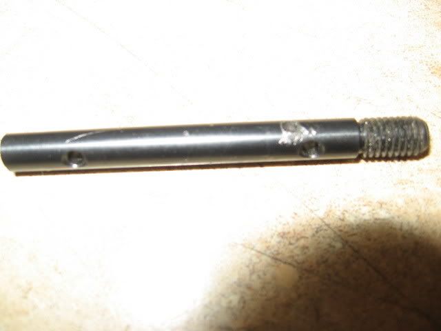

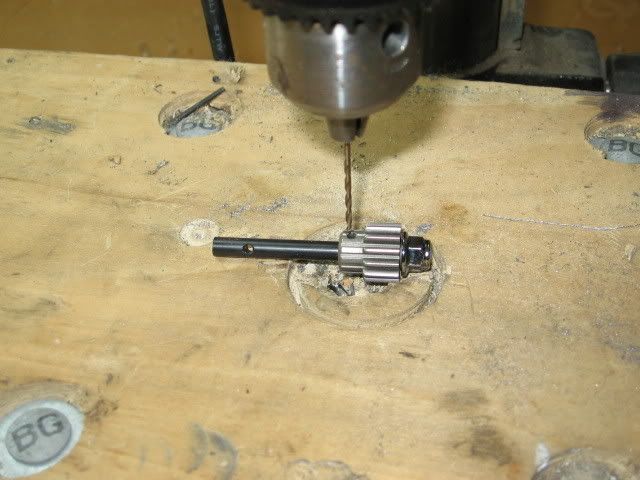

Now use the first gear that come with you part #3933 as a guide to drill your new slipper hole. The new hole should be just past the original slipper hole. I use a axle nut to hold the gear in place so this way I don’t experience any movement and I'm insured a straight hole through the center of the shaft. See pictures below.

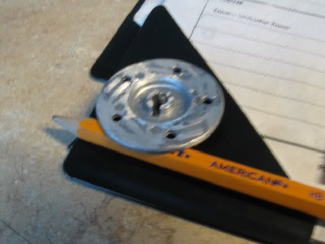

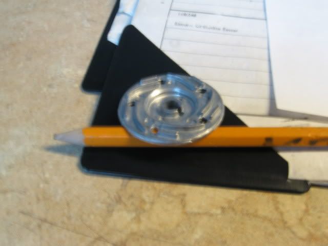

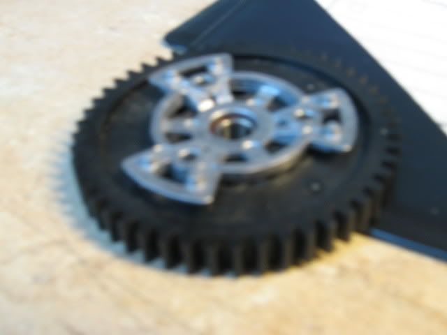

Now grind down the fins off of the slipper clutch system, see pictures below
http://i264.photobucket.com/albums/i...7/IMG_2561.jpg
http://i264.photobucket.com/albums/i...7/IMG_2562.jpg
That it! You’re done with your output shaft!.
http://i264.photobucket.com/albums/i...7/IMG_2567.jpg

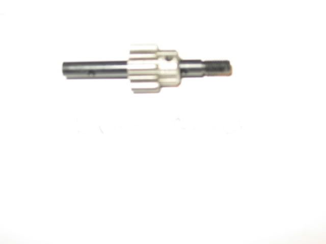

Install the shaft in the Trans and install the slipper clutch system, this should leave you with an extremely close fit which allows you to install your pinion gear closer up the shaft with far less stress on the Motor output shaft. See pictures of the final product.

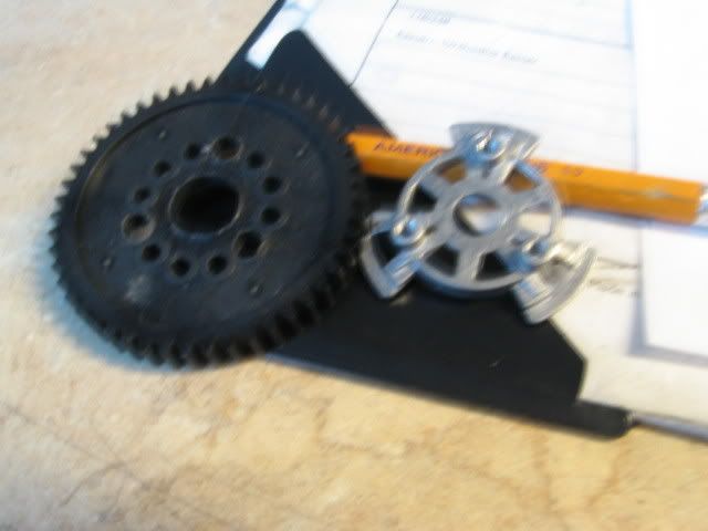

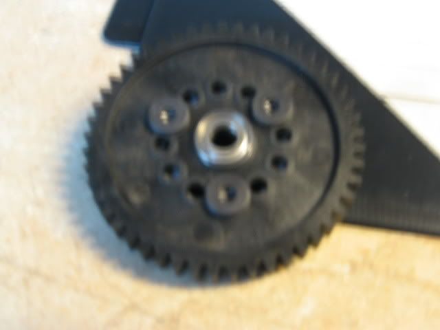

You will need to also determine which spur gear you will be using?? If you are using a Mod 1 gear, simply drill (3) holes out with a 13/64 bit and drill out the center hole with a 27/64 bit. See pictures below..
http://i264.photobucket.com/albums/i...7/IMG_2563.jpg
http://i264.photobucket.com/albums/i...7/IMG_2564.jpg
http://i264.photobucket.com/albums/i...7/IMG_2565.jpg
That’s it, now you’re done with your Spur gear!

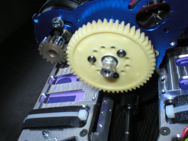

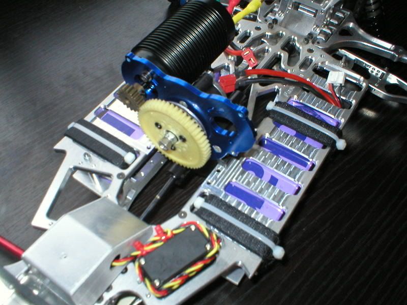

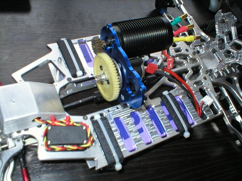

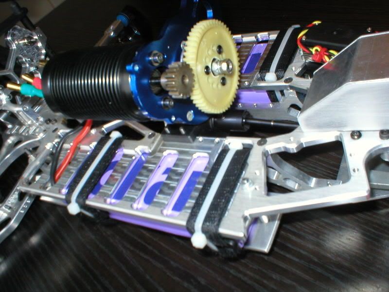

Hey Thanks TDC59 i just wanted to say your directions worked great. I have made one of these for my friends but this is the first one i made my self. The one i made him i drilled a new hole for the gear and this one for myself a new hole for the slipper. I do like this slipper setup becuase i have much more options. It took me about 30min in the garage. Anyways here some pics of it mounted up.
