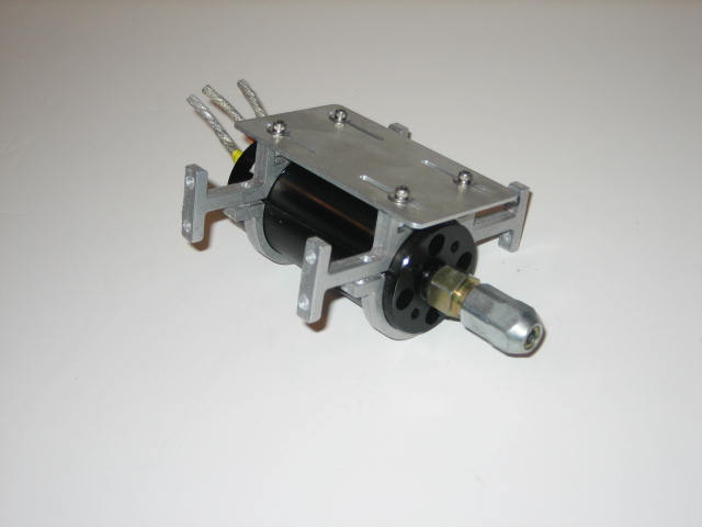

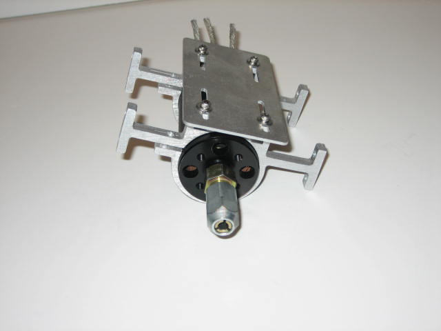

I don't have your vehicle, but I'm going to do that. I have bought some mount that will allow me to do it with out a problem. I will use a Ofna MBX. I will do rear wheel drive at first, but later I will get a motor from Neu with long shafts on both sides like what B4max has.

The Diff Picture that Desmo posted is the results of running Truggy gears. 10 tooth pinion on a 43 tooth ring. 4.3:1 gear ratio sounded appealing with the 5.75" tires. BUT the fact that they are spiral cut, tended to side load the pinion bearing like a thrust bearing. Those are Ceramic Nitride Bearings (the best) and they were destroyed on the very first run. Spiral cut gears won't work with this type of direct drive application. I have had success with the 13/43 straight cut diff gears, but to compensate for the higher ratio, I suggest using a tire that is smaller than a 5.75". Mine worked with the 5.75" tires, BUT starting amp draw was really high which cut runtime alot. @Brushless Boy - The Turnigy motor looks good, but those others look huge and I don't see any specs on those. Why don't you guys put together something like this? It's a AXI 4130. It's 6mm motor shaft is actually a stock output shaft to a Revo Transmission. Just knock the hump off the center of the shaft and it's a direct fit. Makes like easier in the driveline department too. Plan on using CVD's also. These Plastic ones won't hold up. http://i160.photobucket.com/albums/t...m/DSC06631.jpg |
