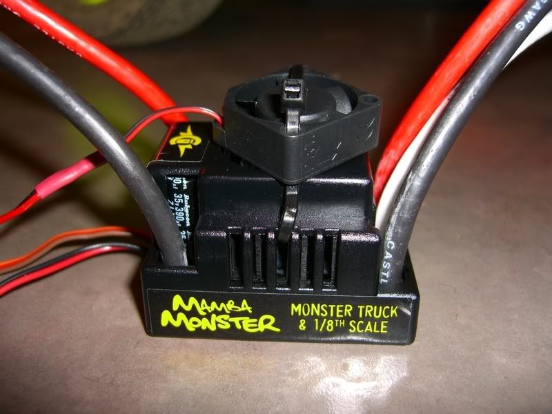

Fan failures will add up fast. The fan as it is now is pure junk. Just about everyone I know who has a working MMM also has done some sort of fan modification.
2 MMMs. 2 dead fans. So far batting 1000. Both have less than a couple hours of run time.
Here is my solution. See picture below. I'm pulling the dead fan and strapping a 25mm fan to the top over the fan hole and letting it blow into the case. The 25mm fans I was using on the MM and R1Pro are much more robust. I wish I could remember where I got them. I bought a lot of 10 for a good price like a year ago adn now I cant remember where I got them. Anyway, the 25mm fan moves more air than the 30mm fan that came with it. I can feel stronger air flow comming out the side vents of the MMM than with the stock 30mm fan. Not pretty, but it works. http://i66.photobucket.com/albums/h2...z/CIMG3194.jpg |
And to be clear, Serum and Mike are the Masters. I'm just an Apprentice. :lol: |
The new fan looks like it might be a hair too thick and it's not the same dimensions, so the little snap-in posts won't work.
