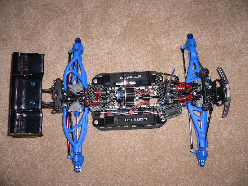

Here are some pictures of the progress I have made so far. A guy on ebay was parting out a Revo Platinum and I ended up buying alot of parts from him. I plan on using the MMM combo in it once castle releases it. What oil and springs work well in a truck like this? All advise is greatly appreciated. :yes:

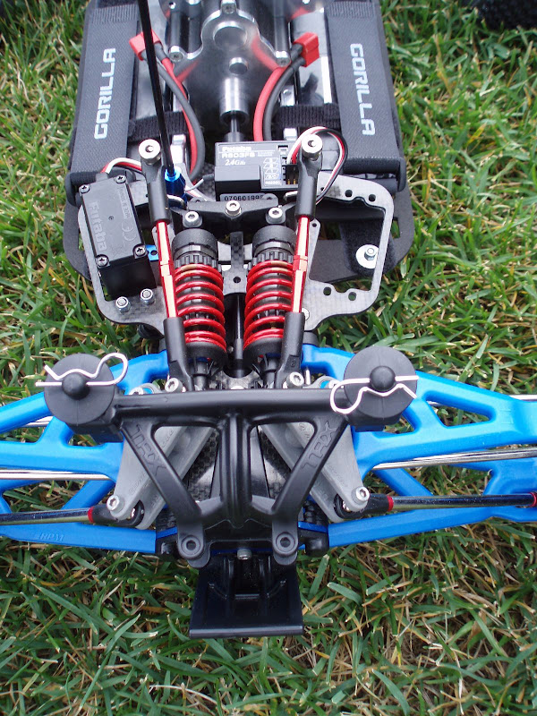

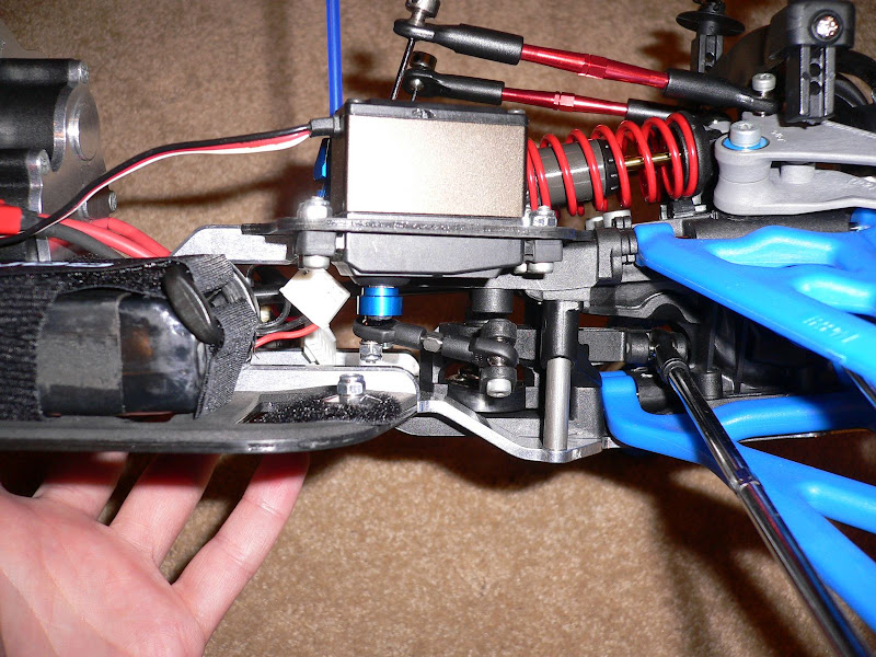

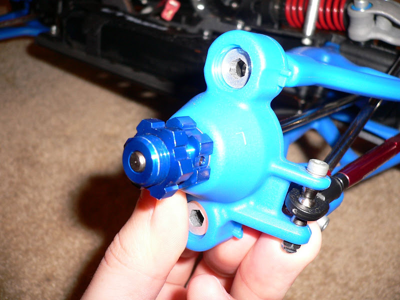

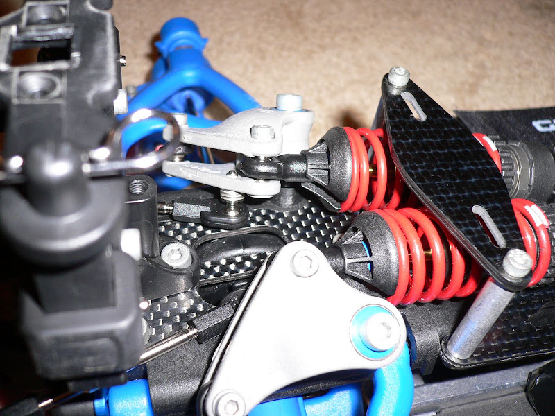

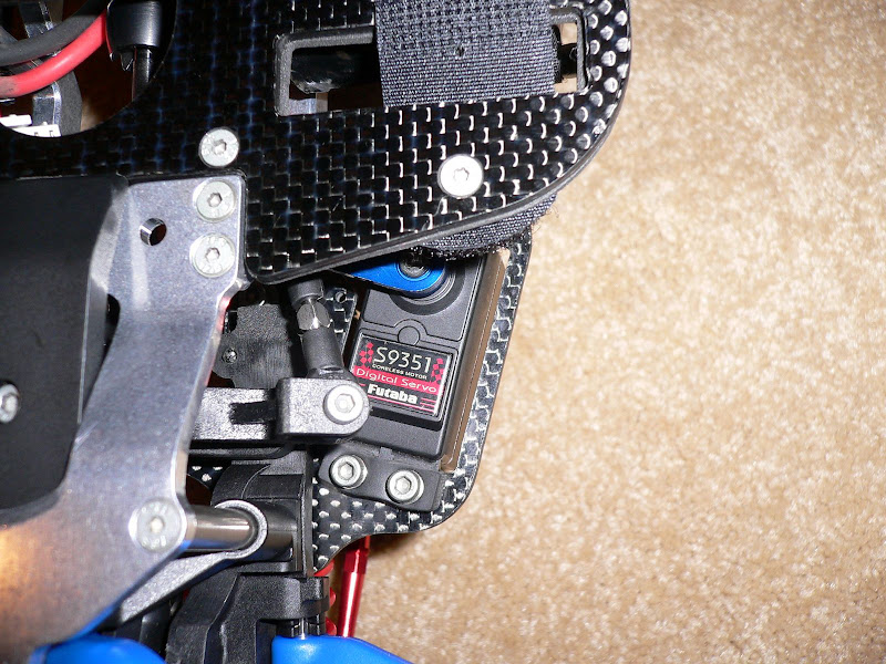

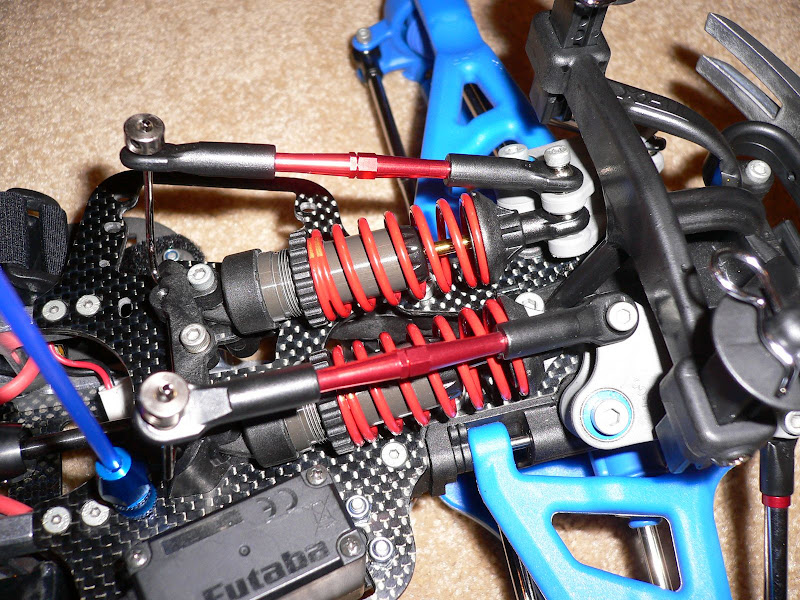

http://lh6.ggpht.com/raddeering/SDyv...0/P1040468.JPG I am currently using the smallest lunsford turnbuckle that my LHS stocked. I think that it might be a little too long. What should I be using here? http://lh3.ggpht.com/raddeering/SDyv...0/P1040469.JPG http://lh3.ggpht.com/raddeering/SDyv...0/P1040470.JPG http://lh3.ggpht.com/raddeering/SDyv...0/P1040474.JPG http://lh3.ggpht.com/raddeering/SDyv...0/P1040482.JPG http://lh4.ggpht.com/raddeering/SDyv...0/P1040476.JPG http://lh3.ggpht.com/raddeering/SDyv...0/P1040477.JPG |
Looks good, do you plan or racing at track with it or bashing? What rockers are you using?
That is a great looking set up! :yes: What voltage do you plan on running the MMM combo at?
I would say that you need the stock servo horn from a revo. It is much shorter than the blue al one you have. Plus I would think that the g3r kit would use the stock 2.5 revo link that connects the servo horn to the steering linkage, but I ma not sure.
Pics: http://www3.towerhobbies.com/cgi-bin...?&I=LXHGB1&P=7 |
DRIFT BUGGY - I am using P2 rockers rockers right now. I think that I might end up switching to P3. On paper it sounds like a good idea but I am not for sure. I will use it for racing and bashing.
jnev - Right now I have some old MaxAmps 2s 6000. I think that I will end up purchasing some 3s lipos. I want the truck to be faster than the nitros and last run for atleast 20min. What should I use? Lincpimp - I bet that would work alot better. Thanks for the link. |

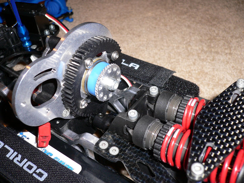

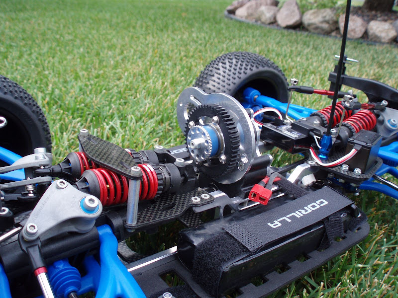

This is my first brushless MT conversion. I took a few year break from the hobby and when I came back I was shocked to see how things have progressed. Its amazing! :surprised: I bought the slipper from a guy on ebay. I think it was someone from the forums. It seams that the sprong is actually some sort of harder plastic. I thought it would be softer. Hopefully it will work out. If not I would really love to have a center diff. I was planning on mounting the reciever so that the antenna can go right into the antenna mount. And the MMM would be mounted where the second servo would go, probably on a piece of CF. Last night I was looking at my drive shafts and I noticed that the Traxxas appear to have a little wobble. I was wondering if yours were the same way. I also have a huge amount of play with my front Gorillamaxx drive shaft. It was soo bad I ended up going to Dorn Hardware and getting some springs to use in the drive cups. Thanks for the help! :mdr: Quote:

My driveshafts have alot of slop in them too (diff to wheel shafts), its right around the UJ area, but its hasnt caused any problems to date- very sturdy shafts to be honest.
Small springs (from a pen?) or some fuel tubing usually cures the center shaft issue by centering them in realtion to the drive cups at each end, but if they are too loose they can tend to pop out sometimes- time will tell. |
I'd rather use small o-rings to take up some slack on the center shafts. As for the Strobe sprong, I was about to buy one for $25 but I chose to use a hard rubber gasket for kitchen faucets that I bought from the jJpanese hardware store for $2 and inverted a stock 3906 slipper metal holder to keep it in place. I have not run it yet but it looks like it would work. If not, $2 is nothing to worry about :).
Check this thread: strobe+sprong |

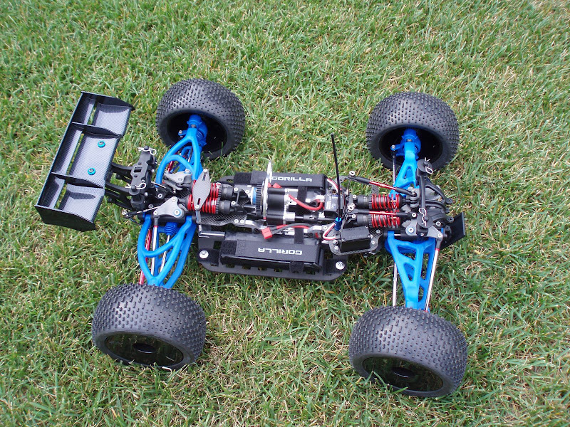

Hi Guys! It has been a while since my last post. Things have been really busy around here (not RC related unfortunately:oops:). I took some pictures of my Revo this weekend. I am getting really anxious for the MMM to finally be here. I am wondering if I should purchase the Castle Creations 2200kv motor or if I should get the Techno Neu 2.5d/f. I have noticed that most members have a lower kv motor for 6s. I want good run times but I also want the truck to be capable of 50mph. Hopefully I will have this truck running by next year. :lol:

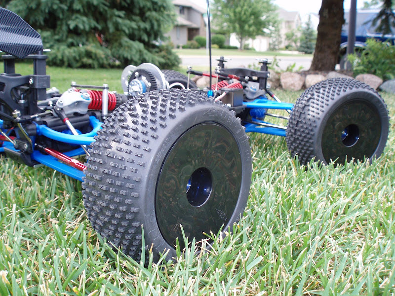

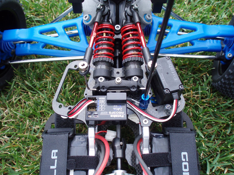

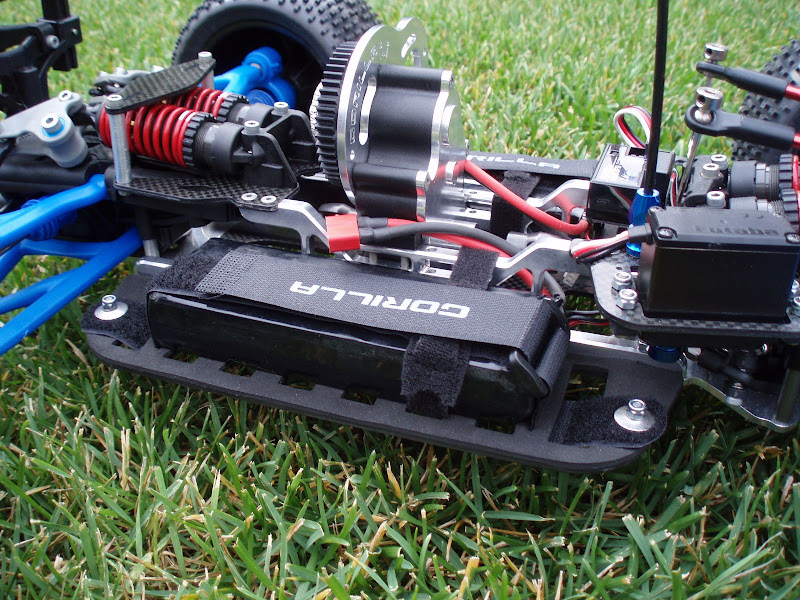

http://lh5.ggpht.com/raddeering/SJZP...0/P8030305.JPG I finally bought another 3ghz receiver. I was thinking about mounting the MMM where the second servo would go. I am still undecided on what I should do for a front bumber. I was thinking that I might trim up the stock one to fit under the body. http://lh4.ggpht.com/raddeering/SJZP...0/P8030307.JPG You can see the spring that I used in the drive cups at this angle. I like George16 idea with the o-rings and will end up doing that. http://lh6.ggpht.com/raddeering/SJZP...0/P8030312.JPG Some old lipos that will have to work untill I get some extra cash for two 3s packs. I was looking at the Trackpower TPTXX49003S. Does anyone have experience with this pack? http://lh5.ggpht.com/raddeering/SJZP...0/P8030308.JPG Another picture of the Strobe Slipper. http://lh6.ggpht.com/raddeering/SJZP...0/P8030309.JPG Brand new Proline LPR Bow-Tie tires on black rims. SEXY!!! http://lh4.ggpht.com/raddeering/SJZP...0/P8030310.JPG I got photo happy and took some pictures of my other "baby". Awesome for me that this one has a speed control. :lol: http://lh6.ggpht.com/raddeering/SJZQ...0/P8030314.JPG |
