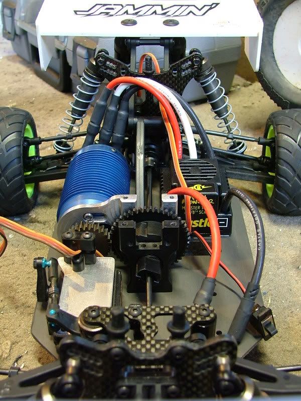

Wow, the mount would be the last thing I would expect to bend. I've broken just about everything else on my CRT.5 but the mount is perfect. And I'm pretty much doing things to my poor CRT.5 that it was never designed to do. :mdr:
http://i21.photobucket.com/albums/b2...e/DSCF3339.jpg

lol i was always wondering if a 1515 would fit in the crt.5
one question where does the battery go?
