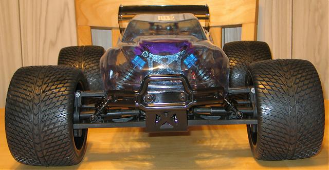

Hey guys,
I'm new to the site, but not to R/C. I've heard great things about this site and wanted to be a part of it.
This is my E-Savage running:
GCMachine RoadBoy BL chassis
SuperGlide ball-bearing steering setup
HPI Hellfire wing and mount
HPI E-Firestorm CF shock towers (doubled up)
Proline 40 Series Wabash rims (painted black with Krylon Fusion)
Proline 40 Series RoadRage tires
All bearing has been cleaned and lubed with synthetic oil... Smooth
Diffs all shimmed and tight
JConcepts Revo 3.3 HD Illuzion body
RPM E-Savage bumper mounts w/ RPM Revo black bumpers
Hope you like it.
Trying to decide on what motor setup to run. Any input would be greatly appreciated.
Can anyone tell me if running two 13X3 and 8 cells... will get this beast going at a decent rate?
-ST

do you have a budget? if you can afford $250 I would go with a Neu..with a Savage you could go with a 1515 can the windings depending on the voltage you will be using...some have used a 1521 but I would stay away from that unless you are prepared to invest in drivetrain upgrades especially diffs

How about the 1515 1y on 5s with a MMM? Might be out of budget, but it would scream. (:lol:A screaming savage)

than a Medusa or Feigao are your options with a MMM
Topspeedtimmy 06.25.2008 02:39 PM
I'd recommend a Feigao 10XL on 5s lipo with the MMM, for a fast 40-45mph setup. That motor and speed control would only cost you $260-280.

I'd be inclined to say a pair of 550 sized motors rather than 540s, otherwise you are looking at very high temps trying to push a ~10lb truck. I wont say titans though, but instead maybe something from Kershawdesigns, like the 650 or 700HO motors, he also sells suitable motor mounts for the larger diameter 700H0 motors, nice guy to deal with apparently (Like RC-Monster... but in a shed).
