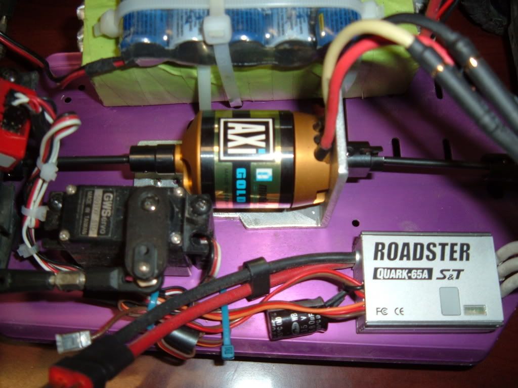

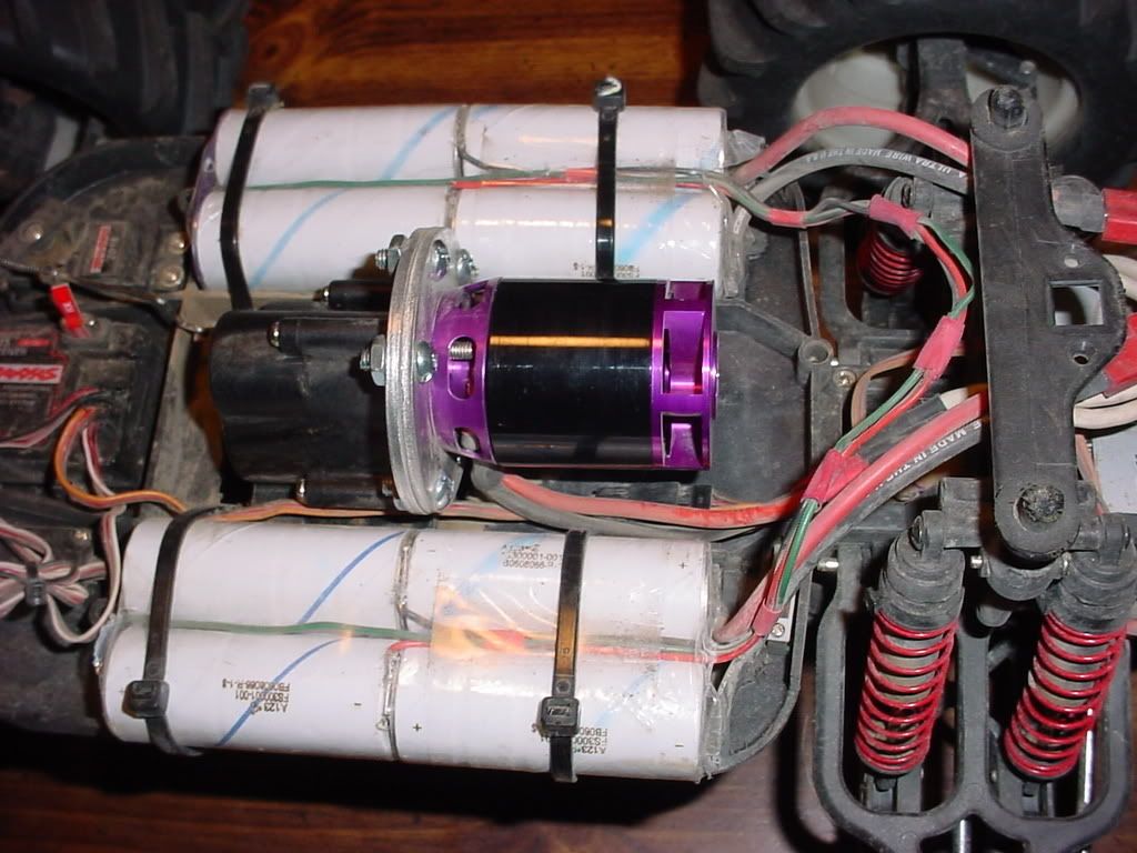

http://i160.photobucket.com/albums/t...m/DSC06449.jpg
Here is slikeston34m's outrunner emaxx tranny setup. He replaced the outrunner shaft with a longer 5mm shaft, and placed the input gears on it.

Sike used a 2826, but he retained the spur and pinion for addl reduction to make up for the losss of torque. He is the guy to talk to as he has done alot of testing with the tranny setup in the above photo. I use a 2826 in a direct to diff setup in a 10th scale 4wd, and that is about the limit for that size motor before it gets too hot. It may weight 3-4lbs. Your maxx will be twice that or more depending on battery choice.
http://i206.photobucket.com/albums/b...p/DSCF1688.jpg
