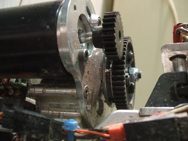

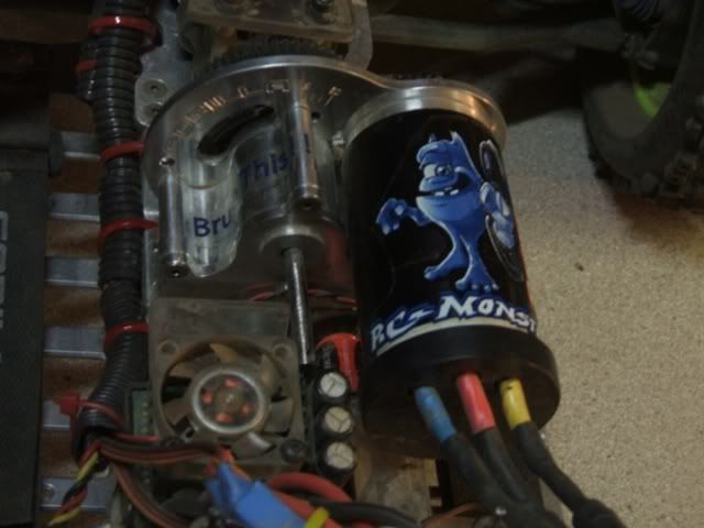

http://i212.photobucket.com/albums/c...ashocks006.jpg http://i212.photobucket.com/albums/c.../rcmdecal2.jpg |
Just contact MetalMan, he can fab you up one, I think truckbasher is / might have him do one for his build, maybe you can get a bulk rate?:whistle:. Travis is always welcome to use mine as a template you guys. I'm with Gee... :yes: (nice shoots by the way Gee!) You want to do it right and install a G1 trans, they are as rock solid they looks great and it’s light. Builders Note: If you install a 3905 trans on a GM chassis you will be limited on your spur gear to 48 (i think)..:oh: Either way congrads on your upcoming build.. :yipi: Have a great one.. |
