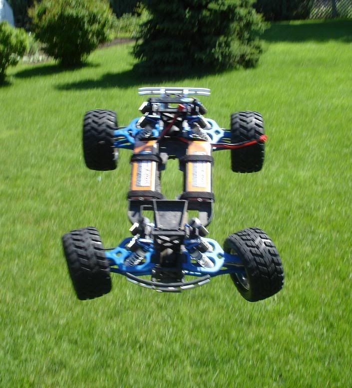

Well Ive had my e-maxx sitting for awhile now and its been colecting dust. Well Ive decided not to sell it because I'd totally regret it seeing that it was my first 4wd MT. It has a fair amount of upgrades on it including new RPM arms, New MIP shiny CVD's, Integy MSR5 shocks that were just rebuilt, RR diffs "rear diffs is locked", 3.3 bulkheads, 3.3 shocktowers. Now Here were the build starts. Im looking to running dual 37.5/48 outrunners which I already have and are waiting to be installed on something, Dual 100a Ebay ESC's, (2) 2s FlightPower 3300mah 25c lipos, Extended new E-maxx chassis, revo center driveshafts, new body "dont know what". I plan to run dual 3s-4s soon if I can find a deal on them "looking into protek again". Here are some pics of it so far...
http://i301.photobucket.com/albums/n...Picture189.jpg http://i301.photobucket.com/albums/n...Picture186.jpg http://i301.photobucket.com/albums/n...Picture187.jpg http://i301.photobucket.com/albums/n...Picture190.jpg http://i301.photobucket.com/albums/n...CU/e-maxx1.jpg http://i301.photobucket.com/albums/n...Picture185.jpg http://i301.photobucket.com/albums/n...Picture191.jpg |

the motors match the batts |

it jumps without any power??? amazing!
Well no not really... I took a picture while my bro dropped it and it kinda looked neat so thats why I posted it up.
It's got power, see the batts? :wink:
