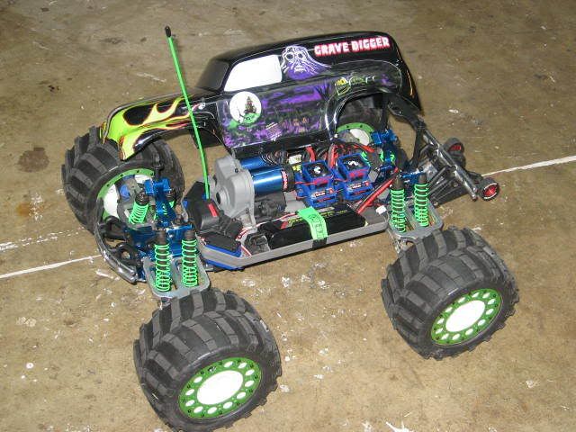

TDC57 07.15.2008 07:30 PM
Nice truck... I had one of those a few months ago and ran it on 2 Velineon and VXL ecs on 6s. ran great..
http://i264.photobucket.com/albums/i...7/IMG_2144.jpg
best of luck and if you need a 3905 trans mount for the FLM just PM metalman and he can fab you up one..
