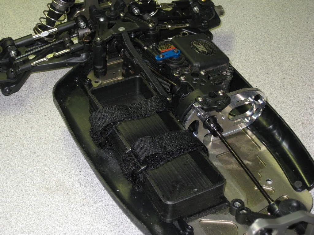

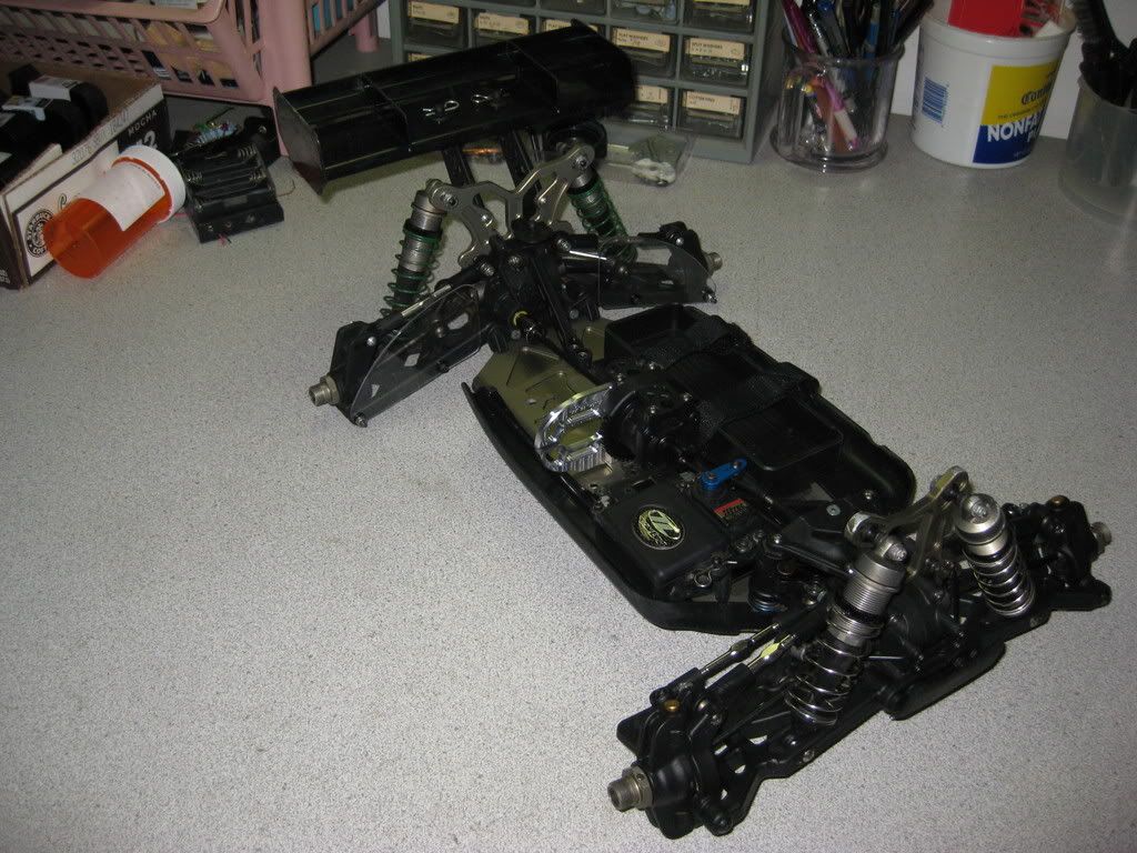

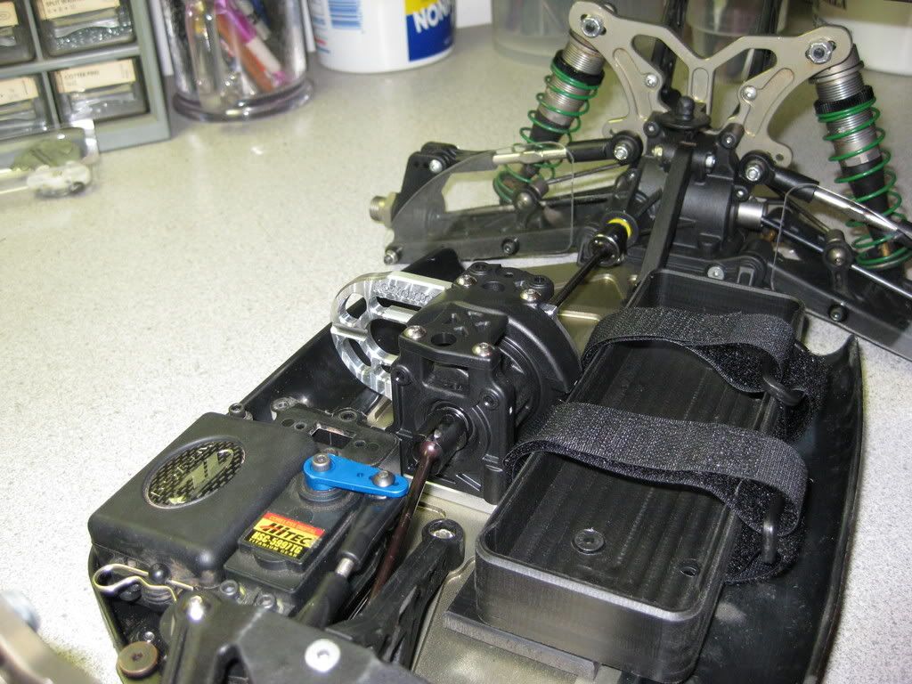

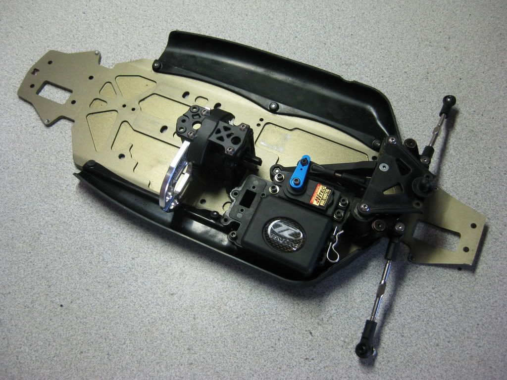

But the main point of this thread (and why I put it in the buggy section) was to show my Losi 8ight buggy that is in progress. :yes: I got the roller for a great price, so I couldn't pass it up. Just a couple more things to do on the battery tray, and wheel nuts to buy, and it will be rolling. :intello: I also now have many spare parts for an 8ight (brand new front/rear diffs with diff cases, brand new a-arms and axle carriers and knuckles, brand new steering assembly, used chassis, and a couple other items), so let me know if you need any of this stuff. I have a Feigao 9xl motor for sale as well. (Thought I'd throw that in there :wink:)

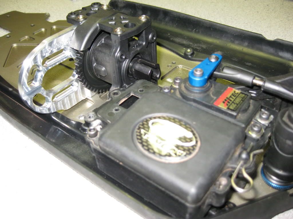

EDIT: I forgot to ask... does anyone know what the circle is for in the motor mount where the screws attach to motor? There is two slots where the screws go in and at the end of the slot there is a circle... anyone know what its for?
It should be so you can leave the screws in the motor and still slide it out. BTW, video isn't there??
jnev 07.22.2008 12:59 AM
Oh ok, thanks pb4. Thats a pretty clever design by Mike. :yes:
DRIFT - Yes, I was referring to the 1515 CC/Neu motor. :yes:
bl-is-future 07.22.2008 09:08 AM
Absolutely correct.

I will admit to being a newb, but what is the benifit of the lexan on the rear A-Arms?
bl-is-future 07.22.2008 10:05 AM
i think it helps to keep dirt away.
Steve Krug 07.22.2008 10:14 AM
Mud guards.

Yah, the lexan is just to keep some dirt away from the shocks. It was like a $1 or $2, so I though I might as well get them.
Sylvester - I put 3 screws going from underneath the chassis into the spacer using existing holes in the chassis. Then I put 3 holes in the actual battery tray that came down through the tray and spacer. I tested earlier to make sure the hole was the right size so the screw would be tight. So in all there were 6 screws used. Let me know if you didn't understand it. I can try to explain better. I am hoping it will hold, but I won't know until I test it... The screws included were also the exact length needed. The plastic spacer is also pretty dense, so I think it will hold pretty tight to the chassis and battery tray. :yes:
