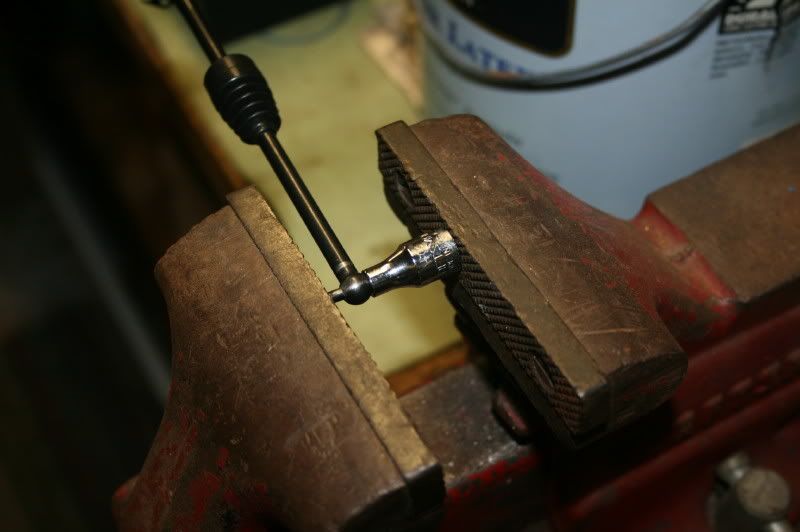

Man this is simple - all it takes is a vise and a small socket from a socket set. Put the socket over the pin on one side and then put this in the vise - you're going to use the vise to push the pin out into the socket on the other side.
Takes longer to explain that it does to do it - just make sure everything stays square so youdon't enlarge the hole so it will still be tight when you reverse the process and push a new pin in. Just happen to have pic -
http://i191.photobucket.com/albums/z...o/IMG_0102.jpg
It takes a little care to get new pin lined up and started squarely, but its not that hard. When you own UE SM you learn stuff like this so you can keep running, lol!!

the only thing about that is how do you get the pin all the way out duster?
Duster_360 07.29.2008 09:22 PM
Once you've got it flush, back the vise up, use anything thats smaller in diameter - nail or a pc of drill bit (shank) and push it the rest of the way out.
UE's use a 3mm pin for center drives and cvds, I bought a 2mm drill bit, cut shank off ~10mm or so and use that. I had 16 pins to replace, if it had been just a few, I would have used a pc of nail.
The above is the hard way - take the end thats stricking out and clamp it in the vise. Takes a few taps with small hammer on side of the dogbone to move it the rest of the way. My experience with these is once pin has moved, it's a lot easier to move it. It might take a bit to make it move that 1st bit (some even make a pop), but past that its all downhill from there.
