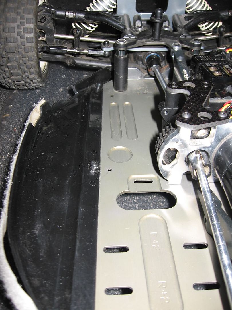

tc3_racer_001 08.14.2008 06:32 AM
yes, that helps alot, coudl you possibly post a pic or 2 showing the tray unmounted and the spacer mounted? (i assume you cut out things like holes for the side guard screw bits etc.
10mm is alot, so being conservative 15mm with strap>?
just paid for the zippy lipo - with a coupon it was pretty cheap :) ($5 off)
thanks,
ryan

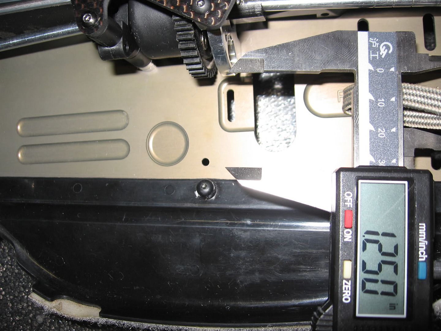

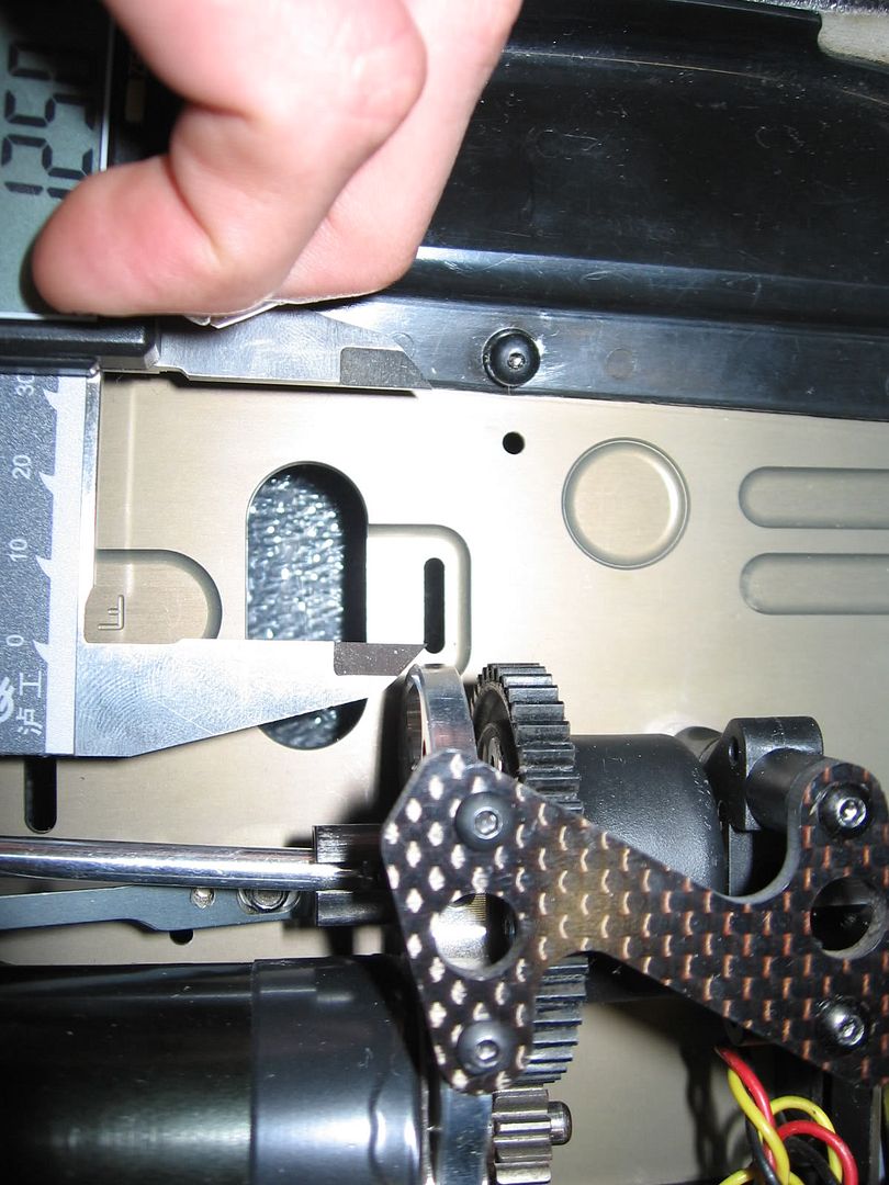

ALSO.
"New 1 piece designs allow 1.25" clearance to mud guard and has no spacer - this design fits most vehicles and lowers battery in the vehicle by .15" vs. the "spacer" installation. Please verify 1.25" clearance from center spur gear to mud guard prior to ordering."
what exactly does this mean?
does it mean this, or something else? the 1.25 is very close, about 1mm less than the thinnest area which is ok, but needs verification!
this should help lower the battery and make it easier to fit :)
http://i260.photobucket.com/albums/i...eries003-1.jpg
http://i260.photobucket.com/albums/i...eries004-1.jpg
http://i260.photobucket.com/albums/i...eries005-1.jpg
thank-you and goodnight!
