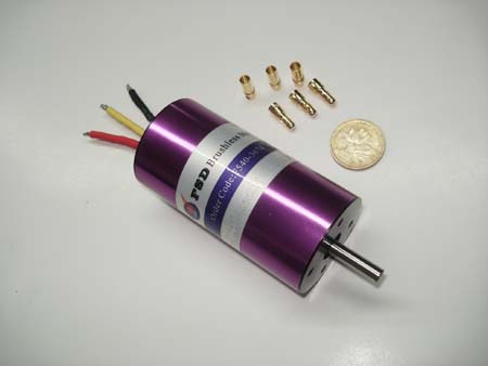

So i decided to order one of these Chinese FSD 2770KV motors to play with to go with one of my MMM in the erevo while waiting for the castle/Neu.
The motor arrived a while back, its got a 5mm shaft and is 35.8x74mm.
it looks like it will bolt up to the stock erevo mount. that said i am concerned about the back plastic plate on the back of the motor.
will the monster rc clamp fit on this motor in the e-revo using the stock motor plate/mount.
I am using the stock 2 motor plate until the single comes out?

i think that motot might blow b/c of the 14guage wires :D, heatsink clamp will work

i dont have high expectations as it only cost $48. im going to run on 4S and see what it can do. If heat and endbell pops were only issue then i figured the clamp would be good idea.

turns out it has 12 ga wires
well i have run the motor in the e-revo, 4S, 20T pinion 68 spur and it seems to run very well. motor got to 150 and the MMM fan didnt turn on. I dont know how long it will last but seems for 48 bucks this is a player until we see castles motor.
