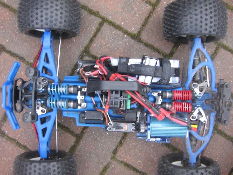

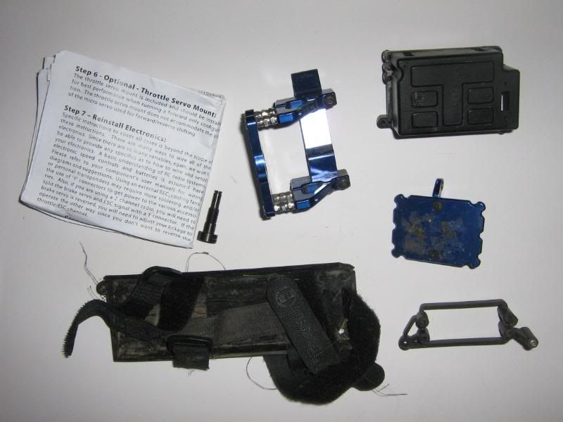

there's no need to buy a new motor mount just look at the way i moved the motor forward:
http://i136.photobucket.com/albums/q...fev22nd022.jpg
or you can just about see it here:
http://i136.photobucket.com/albums/q.../random005.jpg
just put some bolts inbetween the front motor mount part and the rear it works a treat although you will need longer screws...
