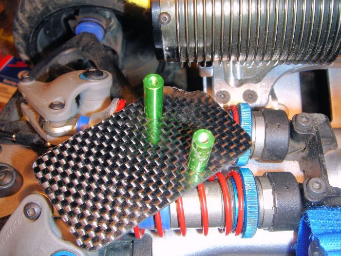

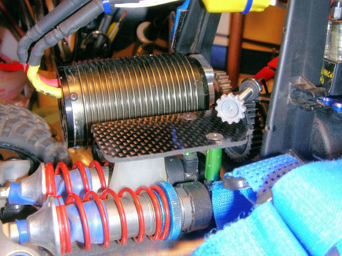

hi all,
i have just recently gotten all my gear together and on installing the MMM on the esc plate from tekno, i discovered that the wires were far too short. so in a lunch time session i made up a plate to mount the esc over the rear shocks using the shock screws as a fastening point. i will be adding longer fasteners and a spacer later on, but this does the trick and very well and cheaply. hope this helps someone.
killajb 09.03.2008 02:35 PM
Is that the 1515 series motor you have in there? If so, is there any conflict with the end of the motor and the rear suspension arm?
123revo 09.03.2008 07:20 PM
hi,
yes thats a 1515, no probs so far with the suspension arms at all with the esc/motor. no doubt i will test its limits :P
123.

Arct1k 09.12.2008 09:01 AM
Just mount the esc over the rear shocks - Just use a small square of plastic - a couple of spacers and longer screws for the shocks.
One thing to watch though is the rear arms - The teckno mount puts the motor a long way back are you sure there is no interference of the motor and arms?

123revo 09.21.2008 05:03 AM
i was careful not to solid mount my plate what with some vibration and shock failures with some MMMs. i have about 3/4 inch clearance under my mount over the rear shocks. in the even of a hard landing it has that amount of rebound slack before it will slam into the springs.
